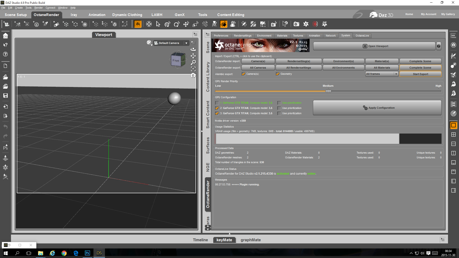

I just found out that somewhere between PreRelease 5th 2.21 and the last beta 2.23 the alembic export functions may have changed.
In the PreRelease 5th 2.21 there was still an alembic geometry export option.
Now it seems since 2.23 there is only an alembic camera export option.
It seems in general just exporting as .abc offers more limited options compared to exporting as .ORBX where all OR specific material information is also included.
The .abc export may have been an alternative export option for some workflows until the .ORBX export was fully functional.
Still it seems odd that the alembic geometry export option was removed but the alembic camera export option was kept.
That being said:
The alembic camera export option CAN still be of use when trying to export just the cameras to other applications that do not support ORBX import.
Having the same cameras including their movement in other applications can make it easier to composite scenes.
