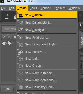

If you're asking how in Daz Studio specifically, all you have to do is create instances. This is done by literally clicking Create on the toolbar, and selecting either New Node Instance (for one) or Node Instance Group (which prompts you for how many instances you want). These are all direct clones of the figure selected at the time you create them. Anything you do to the original is done to the instances.

"clicking Create on the toolbar"
I assume its in the Octane Tool Bar?

bpzen wrote:"clicking Create on the toolbar"
I believe they are referring to the Daz Studio function, under the Create menu.
