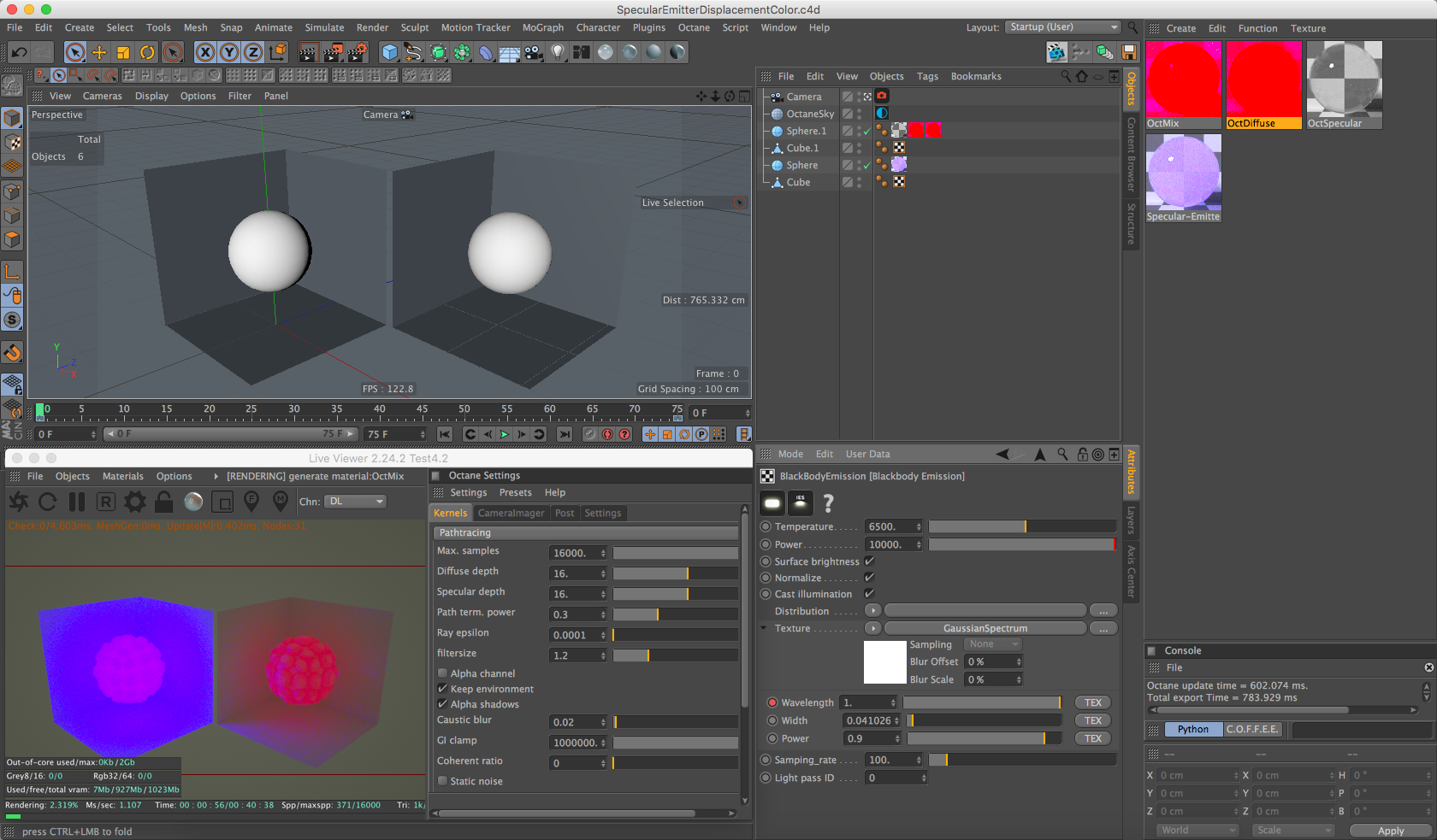

Here is the two methods:
At the left, a single specular material with scattering medium and emission, on the right a specular material mixed with a diffuse material. Both versions have the displacement active.
Here is the scene:
SpecularEmitterDisplacement.zip
(868.13 KiB) Downloaded 382 times
ciao beppe

very interesting project you have! When ready, I would like to see the final result if possible ;)
For coloring the emission, you can use a blackbody node with 6500k temperature, or simply use a Texture emission node, and use in the texture pin an RGB or Gaussian Spectrum node.
Here is the same scene as before with the wavelength animated on both:
SpecularEmitterDisplacementColor.c4d.zip
(83.95 KiB) Downloaded 315 times
ciao beppe
