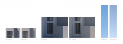

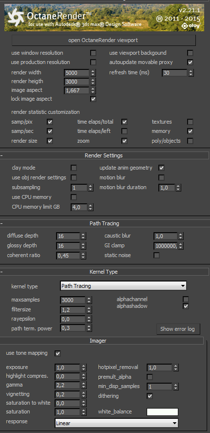

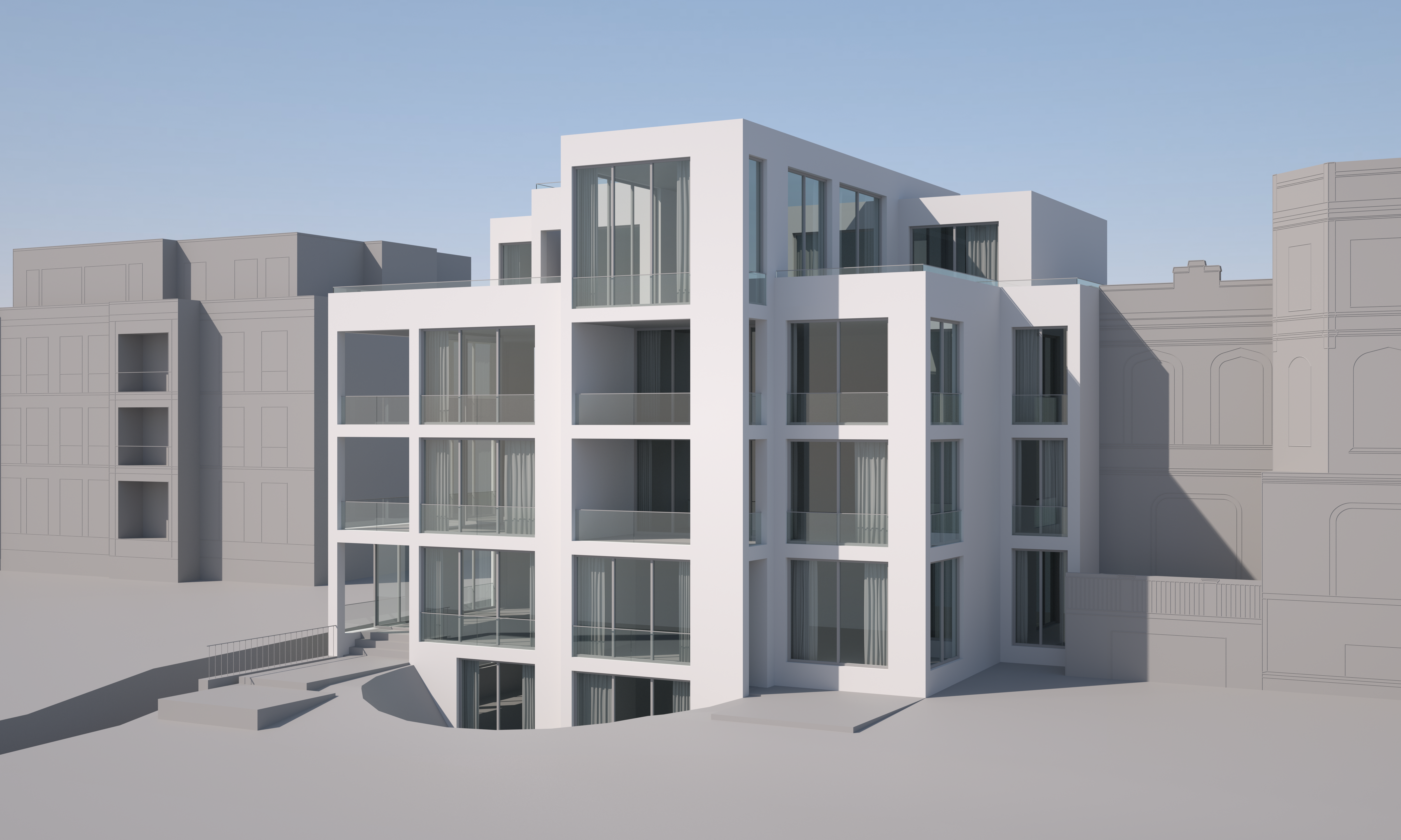

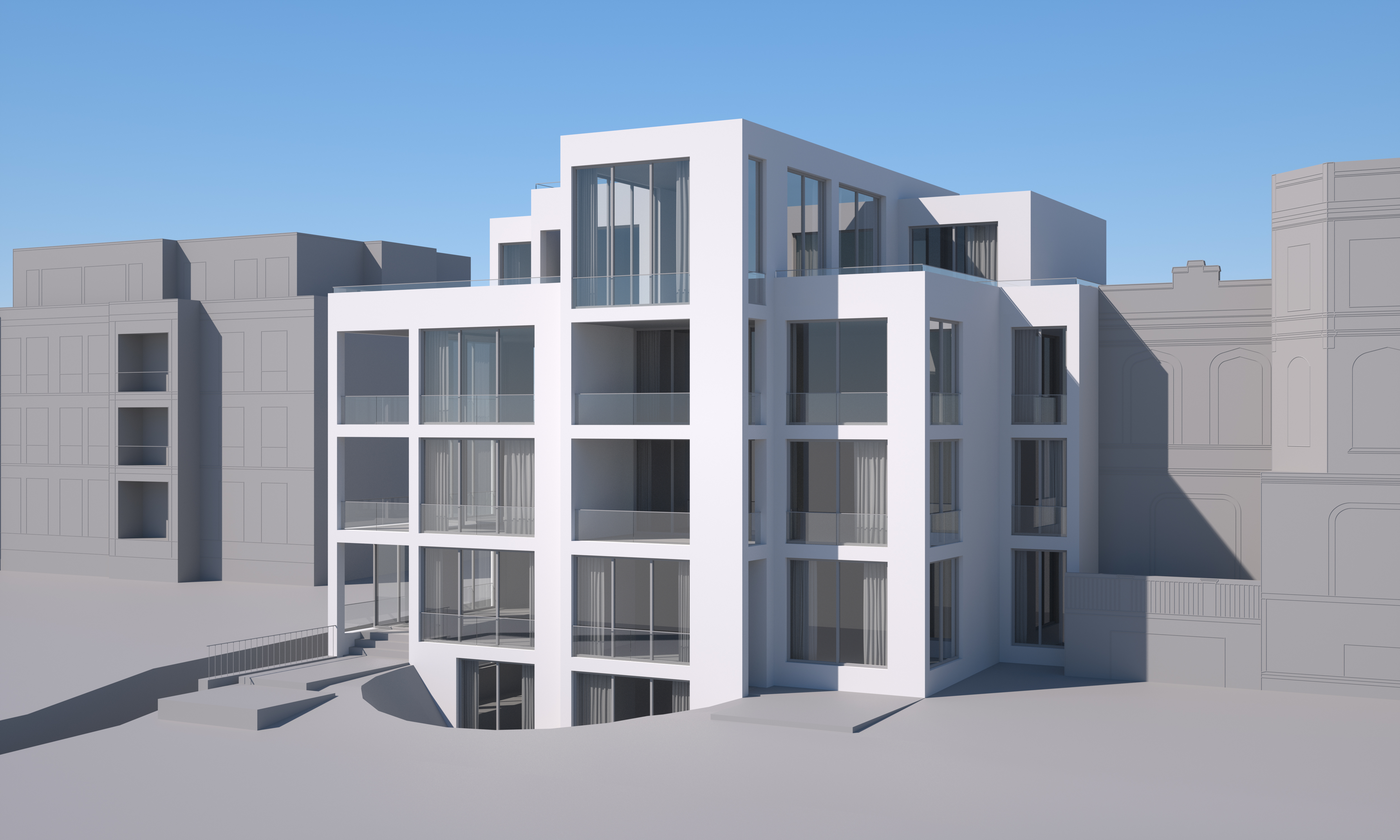

Quick test for fun, forgot how slow Maxwell really is ;)
It's really great that we can adjust the sky and sun color in Octane but I think the gradient in Maxwell is nicer (it gets a lot brighter towards the horizon).
Is the sky or the GI in Maxwell brighter? In shadow areas it seems brighter...
The material for the building in the middle has a "grey" value of 220 in Maxwell and a value of 128 in Octane.
Sky and sun color in Octane are default.

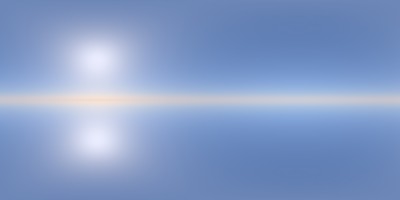

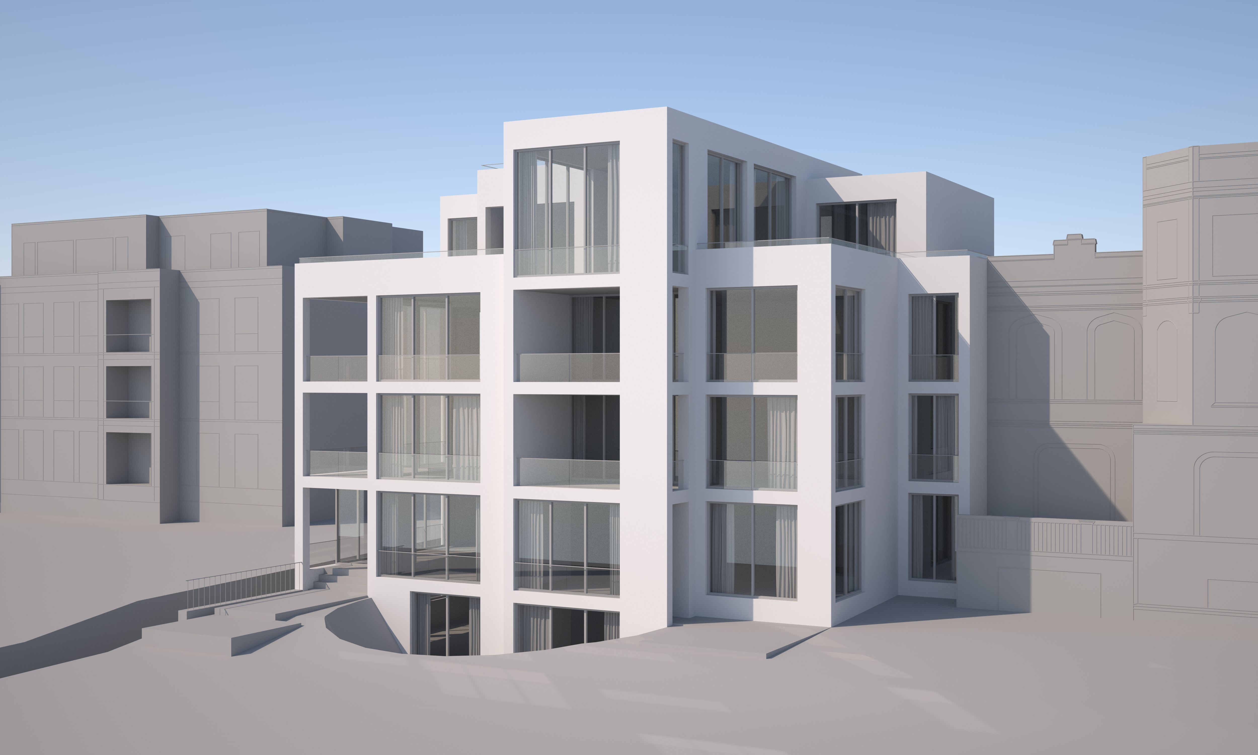

Edit: You can render out the Maxwell sky and use it as a sky texture (together with Octane sunlight). With a little bit of adjustment you can get pretty close to the Maxwell output.
You can download the Maxwell sky, I've used the jpg.
Octane
Maxwell
Octane with Maxwell Sky + Octane Sun

Interesting test and I agree, sky in Maxwell looks more natural and i always found Octane shadows "too dark" with so many GI bounces (i often used like 10+ bounces for exterior) and still find shadow areas too dark in octane. Not sure what's up with that or is there way to change/fix that.
