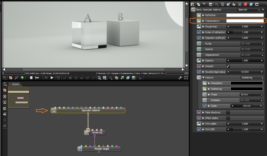

(1) create a specular material and add a scattering medium to it
(2) set the transmission (which controls the amount of light going though the object) to full (white) so you can clearly see how the light changes inside the object

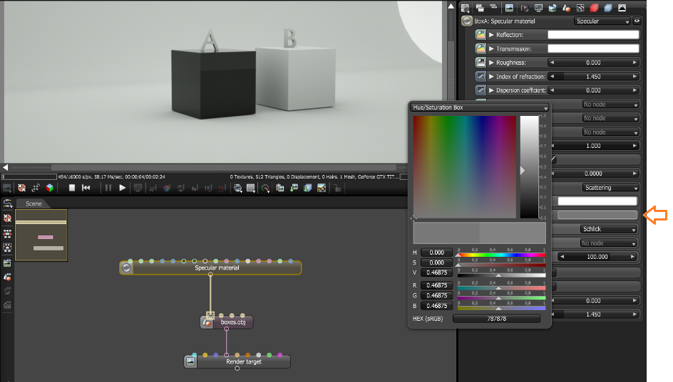

(3) adjust the scattering channel in the medium (this defines how fast light is scattered as it travels through the medium)

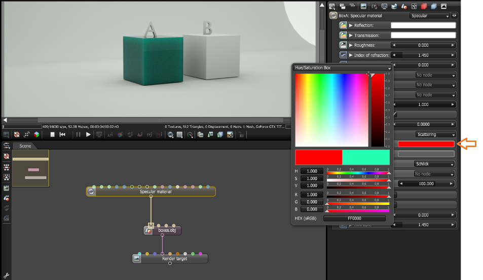

(4) set the absorption color (bear in mind that the resulting color will be the complementary color of the absorption color)
And that's it.

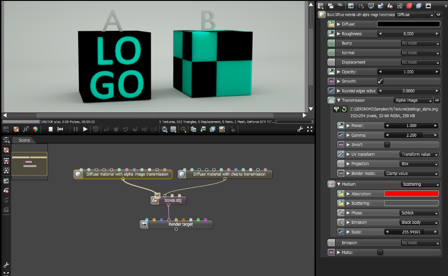

using a diffuse material for sss does have some applications as this will work by enabling the transmission channel with a texture or an alpha image:
you can imagine this being used if some patterns are desired.

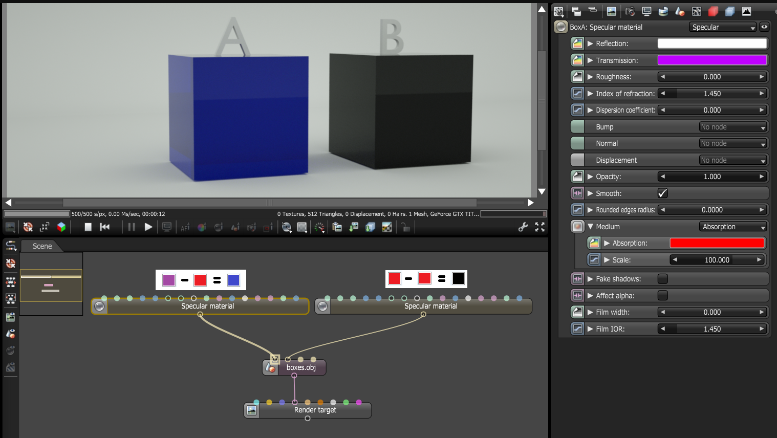

On a previous note, just also want to add that the absorption works in a subtractive way. As you can see here, if the absorption color is exactly the same as the diffuse or transmission, this eats away at the diffuse or transmission:
