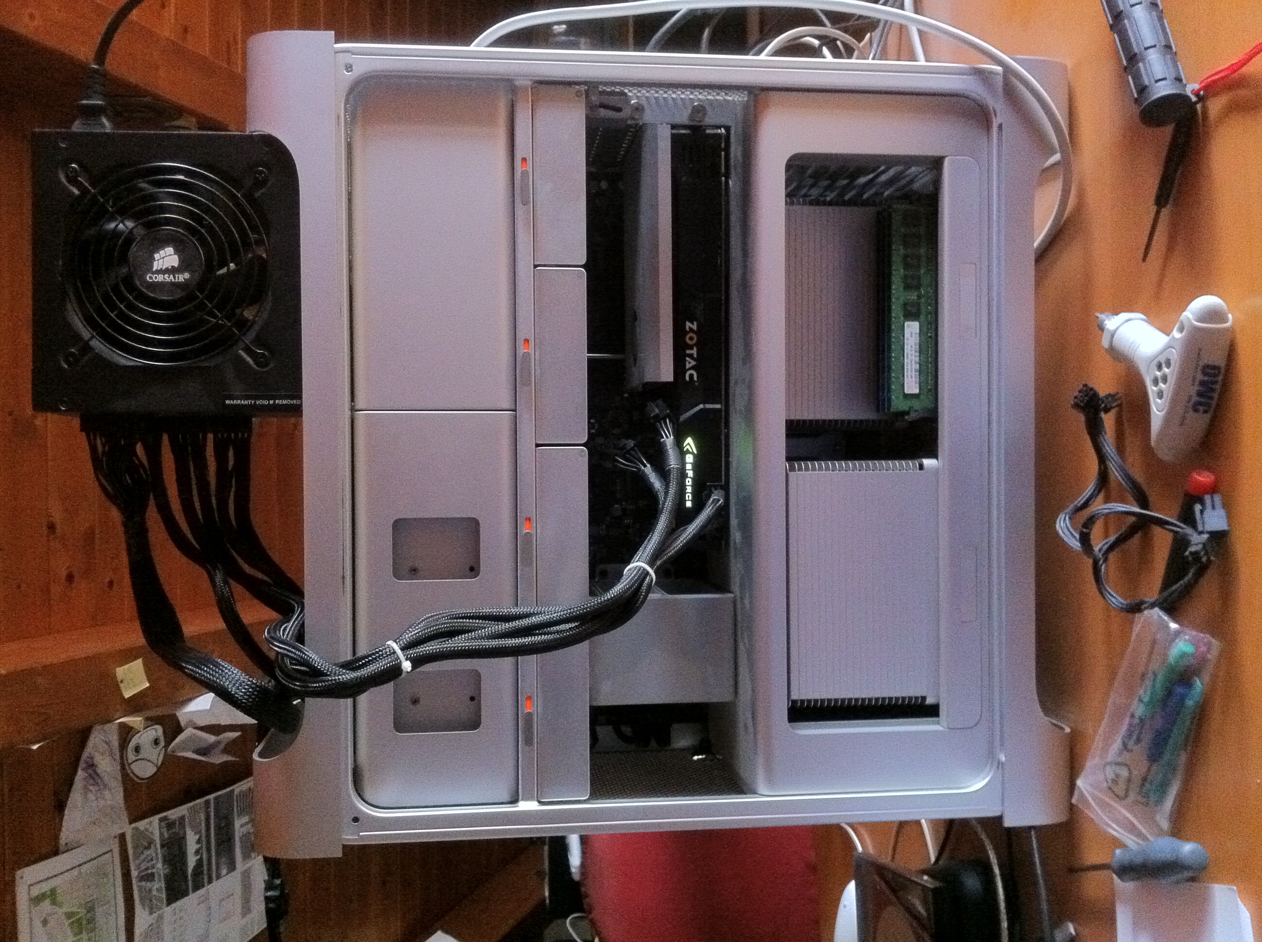

I have the same Mac Pro and I work with it and Octane from 5 years now.. In the past I have used on it GTX 285/460/560/590 and now 780. The monitor is attached to this GPU and it is placed in between the two 780:
http://www.ebay.it/itm/Scheda-Video-Nvi ... Swo6lWQiG8
You can use any GTX PC card, no need for flashed ones for working with octane, but if you don't have an Nvidia Mac card the boot is different and the screen stays black until the desktop is completely loaded (eg. you can't choose a different partition on boot).
It's better to leave the mac opened for a better airflow, GPUs can easily work at 80° degrees and more.
Here is a picture of the coplete set up, it's not very stylish but it works smoothly from years:
ciao beppe

this ven on the top: this this just a van or a power supply?
for some reason i thought you would have put the cards INTO the mac pro
now i think that you might have them i some sort of tray or case in the outside??? my dealer told me a crazy price like 2000 or so just for a case
and that would on top of 2 videocards just to much
would be great to hear from you cause my suffering with my current configuration is HUGE ;O)

the external PSU is necessary only if you want to put more than one GTX 970/980 (eg. one or two 980ti or Titan).
on top of the Mac Pro there is a standard PC PSU like this, for example:
http://www.amazon.it/Corsair-CP-9020056 ... rsair+850w
then you need to make a little trick for let it working without a direct connection with the Mac mother board:
https://youtu.be/5FWXgQSokF4
Then connect the power cables to the GPUs, turn on the external PSU and then the Mac. That's it ;)
There are more expensive external solution, or here is a very interesting solution from another user of the forum:
viewtopic.php?f=9&t=47105
ciao beppe

so your videocards are actually IN the mac and they just get the power from the external PSU?
