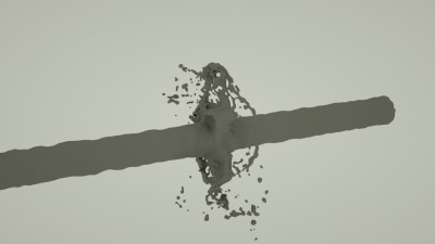

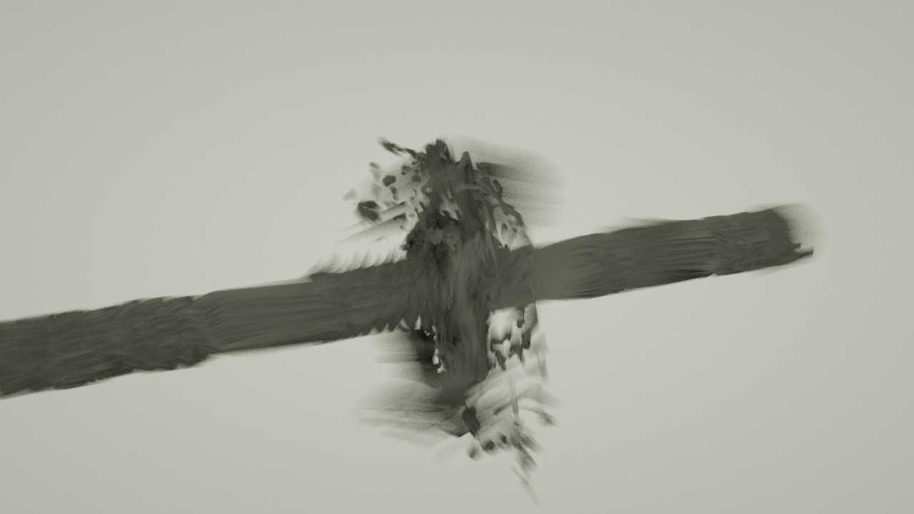

In my case the stitched alembic file actually produces vertex motion blur, yet it is of no use and preparation times / render times per frame explode:
With C4D's "use guids on motion blur" enbaled, there is no motion blur any more and there is 0 [ZERO] additional preparation time:
@ miknik: How did you produce this? Was there a constant point/vertex count? The motion blur result looks stunning! Do I understand right, that this motion blur ONLY works in StandAlone?

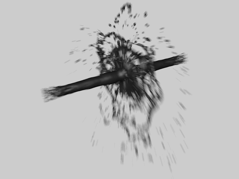

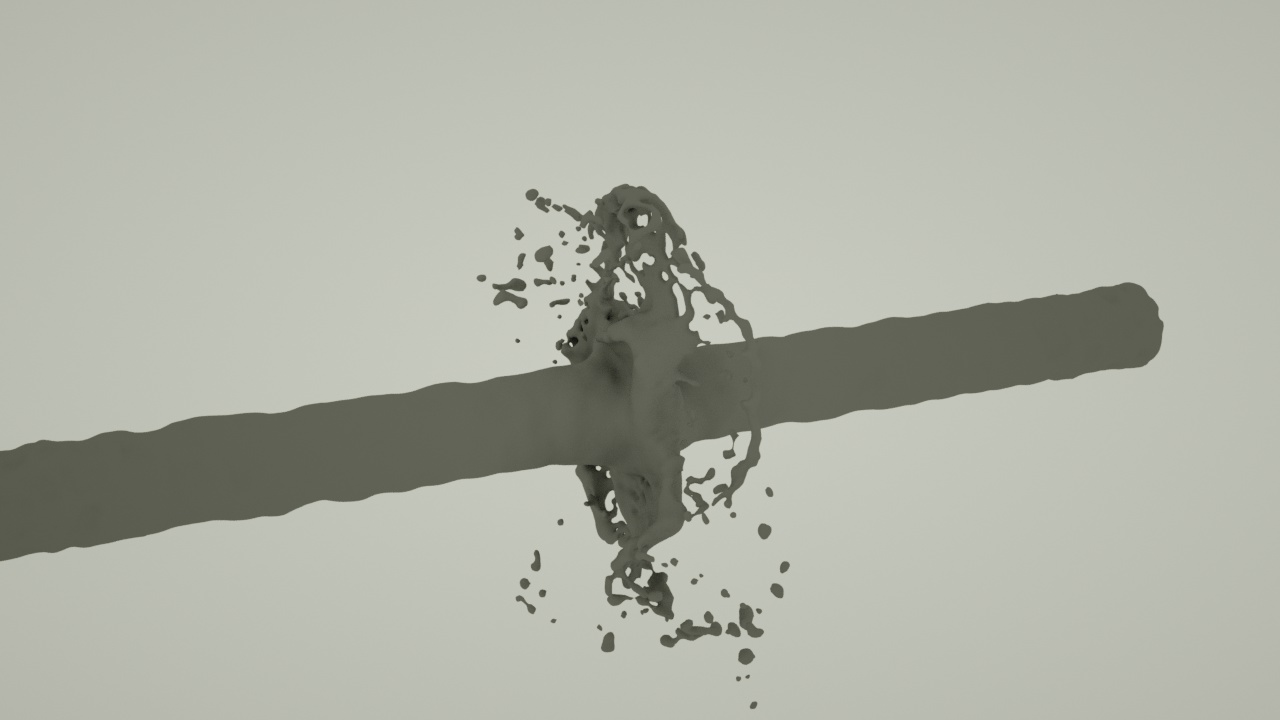

so here are two beautiful examples of vertex motion blur from RF meshes.
so it IS possible, at least in stand alone. I just have to figure aout how the set up my ABC export.
viewtopic.php?f=33&t=44704&p=229784#p229840
viewtopic.php?f=33&t=44704&p=229784#p229971
