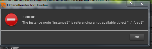

I've come across an error where the Instance object is recognizing relative paths in Houdini but isn't translating to the IPR Octane window. I've been trying to make a digital asset for Octane instancing and this would be a helpful feature to have. I've attached an example file along with a screenshot of the error which pops up when I try to open the IPR Octane window.
Thanks for your help!
Nick

Thanks for reporting. This issue should be easy to fix for the next build.
-Juanjo
