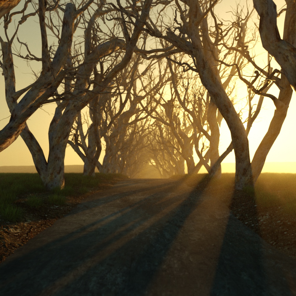

Just an update. The project I was working for has been cancelled due to last sad events in Paris, but here is the scene I was working on... I like the way Octane works with volumetric lights...
