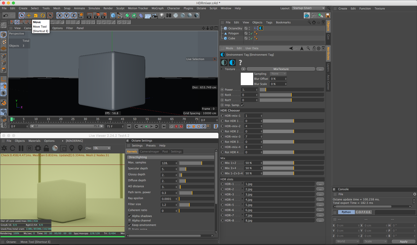

Here is a modified Environment node via Xpresso that let you choose between 8 different textures for a total of 4 HDRIs. Then you can rotate them separately and mix them together:
HDRmixer.zip
(71.89 KiB) Downloaded 329 times
