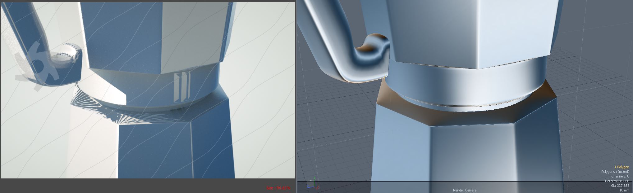

Hi, Im getting this in the octane render, but the mesh is ok
any idea??

I'm so sorry - I missed this post.
Looks like a Kernel->Ray Epsilon issue. Or the normals of those triangles are wrong - in which case select the Mesh, and Geometry-Mesh Cleanup and Vertex Map->Set Vertex Normals should resolve it.
