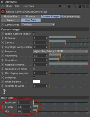

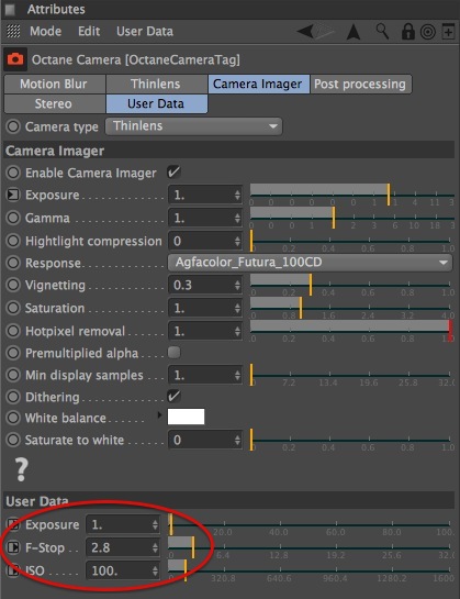

In a lot of the tutorials online, I have seen the Octane camera setup feature an ISO setting.
This feature is not present in the Octane release that I have, but I am up to date. Is it a setting that has been super seeded?

here is an xpresso version of the "old school exposure" scripted graph written by Marcus:
OldSchoolExposure-expresso-01.c4d.zip
(42.38 KiB) Downloaded 463 times
You need to use the parameters in the User Data section for setting up the exposure ;)
