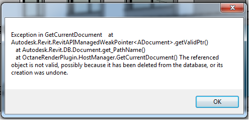

Hi Paul,
I received the following error:
How it happened:
-Worksession #1; opened a new local from the WAN drive, once it had loaded did some work (minor things, moved a few walls and reanranges some signage families). Save, Sync, Close. (inc close revit)
-reinstalled the latest plugins & Standalone (SO)
-Worksession #2 having just installed the latest versions of the plugin and Octane SO. I'm the only one working on the file today so I just opened my local. I Opened up a view without reloading latest and quickly rendered a view. finished my other work, and hit save and got the error.
Workstation has:
Revit (building design suite version - inc. systems & structural): 2015 UR10 for R2
Octane: 2.24.2
O4Revit: 2.24.2.35
CPU: i7-4790 + 16gb RAM
GPU: Quadro K600 + NVidia 354.35 (Quadro performance)
is uninstall and clean reinstall 'good practice' for things like this?
also, on a side-note: is it possible to add a 'purge Octane from file' button somewhere? this could be helpful when you are asked to send files to external parties and do not want to send all your scene setup to them :)
but also, in cases like this it might let me sleep easier knowing the file doesn't have any 'nasties' in it that might affect the project... understand that I'm using the test version. :)
If you follow these same steps again, do you get the exception? When you got the exception, did the Revit file still save correctly?
Doubtful - shouldn't be required. The only time a reinstall is needed is if you install a new version of the plugin, and Revit was still resident in memory and holding a write lock on the octane.dll file (which in theory shouldn't be possible).
I'll check when I get into the office. Changes were committed to the central, so I assume it saved...
I would be interested if you follow the same steps can you can reproduce the error. My guess is that Revit had some sort of random/rare issue and tried to save the scene and passed an invalid scene pointer to the Octane plugin.

Hi Paul, Great news,
I Couldn't repeat the error - I think you're right about it being a random Revit thing.
