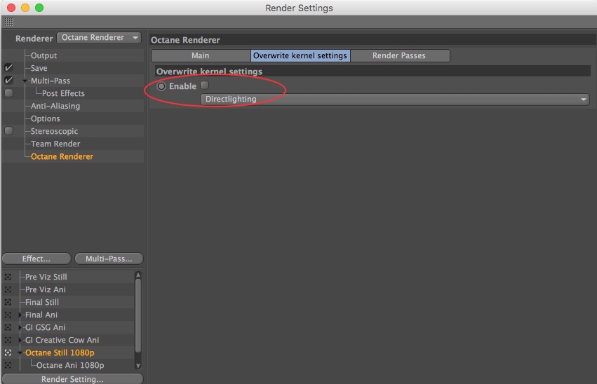

Posts: 10656
it works as expected here, I have only disabled the "Overwrite kernel settings" option, otherwise the infochannel kernel can't do his job:

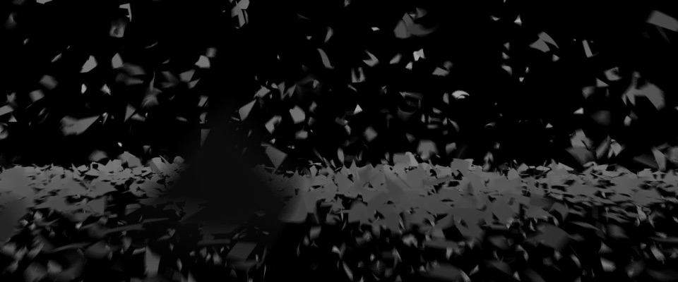

here is the 35 frame:

aggiechase37
Posts: 214
Joined: Tue Jan 13, 2015 6:39 am
Thanks guys. I got it working using the info channels kernel. It took quite a bit of messing around, but I'm good now. But certainly stay tuned for the next episode of chase is a nit wit.
