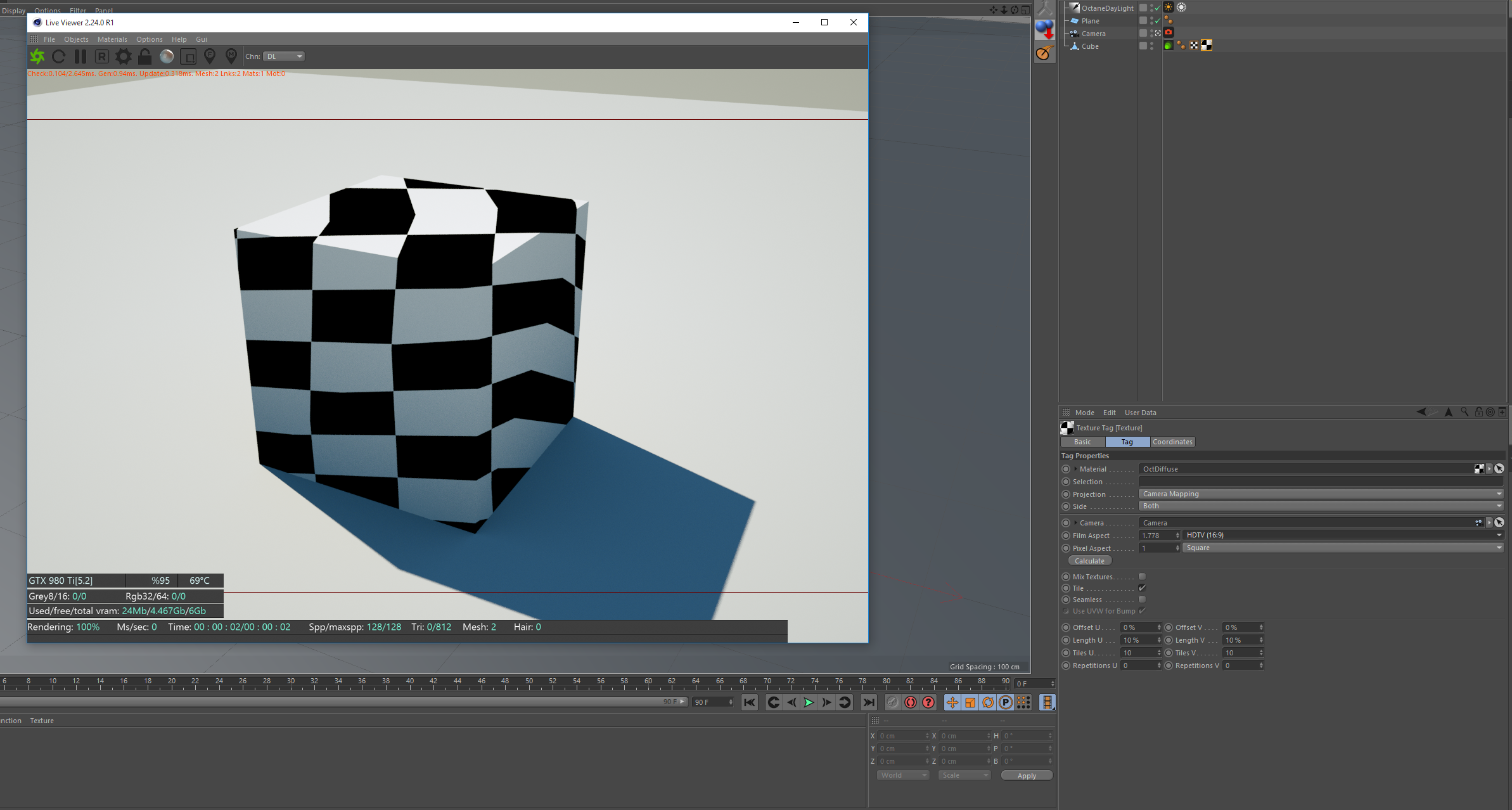

I've been trying to project an image onto geometry using camera projection, but for some reason whenever I try to do so the image appears distorted in the live viewer, even from the perspective of the camera. Check out the image. I'm just using a basic checks texture, but the boxes appear skewed. What am I doing wrong?

I suppose that you are using C4D's camera mapping. This distortion occurs on low polygon objects. Try higher subdivisions on cube.
