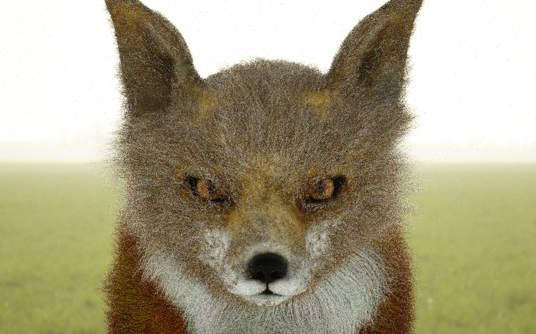

I have a few questions about hair rendering in the plugin:
Is there a way to make the hair take up less vram?
I have a model that needs to be covered in hair ( a fox) and I need about 8 million hairs because the hair needs to be so thin to look correct.
For example, does decreasing the hair segments help?
My 2 GTX 780 ti dont have enough ram to handle this amount, even with out of core textures enabled. Also, the hair renders incredibly slow.
I had it running 8 hours over night and it is still far to noisy to be usable.
I guess the material of the hair has a big impact on the render times.
I used tonysculptors hair LiveDB material on it, which parameters could have the biggest impact on render times?
Also, it seems to render fast if I just use Area light instead of a HDRI, is that correct?
Thanks a lot.

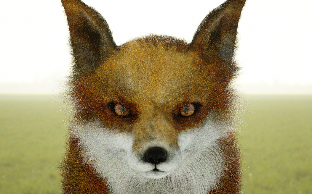

I experimented a bit and what was surprising to me was that the number of hair guides seem to have a huge impact on performance and look of the hair. It seems to be best to use as little guides as possible and let the hair material itself do the variation. I changed from 14000 guides(the default number the c4d gave me for my mesh) to about 500 and the difference in both look and render times is huge. I think also a lot less vram is needed with fewer guides.
Also, I changed from tony sculpters hair material to a more simple one I build for the fur of my mesh.
Adding a hair density map made some problems with the color of the hair. After adding the map, the hairs seemed to have the material that I had assigned used on every hair individually, instead of taking the color from the correspending uv coordinates on my mesh.
