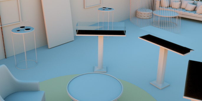

Hi Guys,
Any idea why I might be getting this anomaly? I seem to get black areas under my glass textures ... any ideas?
Also, now sure if this is related... but whenever I use glass textures I seam to lose any / all colour in the model behind it - very odd.
Cheers
Craig
Posts: 10612
increase the specular depth in the kernel setting, or even better change it from DL to PT or PMC ;)
