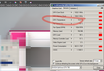

download/file.php?id=36759&mode=view
download/file.php?id=36760&t=1
it all depends on the motherboard .. how much is it supported video cards at the same time. + DR render - the most budget option works for me for 2 years ... no problems
