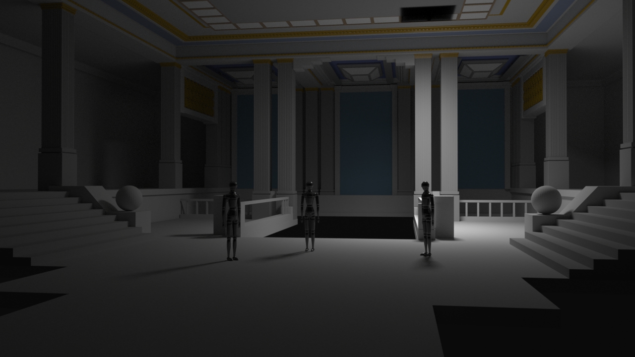

If I understood you correctly, this is easy: Just in Light properties, set Shape Opacity to 0%mstewart152 wrote:is there a way to get the light to not cast a shadow from itself? i checked "shape cast shadow" option in the light properties, and nothing happens. You can clearly see the shadow shape on the ceiling in the image. light is pointed down. I also have visibility to camera turned off.
That way light works normally but is not visible as an object in the scene

im an idiot.... THANK YOU. LOL.
face palm.
face palm.
No problem, it is very different solution from std LW so it's easy to missmstewart152 wrote:im an idiot.... THANK YOU. LOL.
