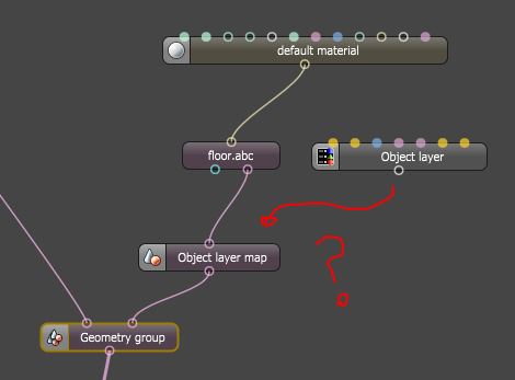

Nearly two years on and I've decided to give Octane Standalone another test now that I know HDR Light Studio might be coming to stand alone soon.

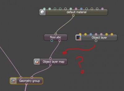

I want to use an object layer node to change the primary visibility of a mesh. The only problem is I cannot find anything to plug the Object Layer node into.

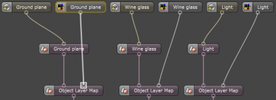

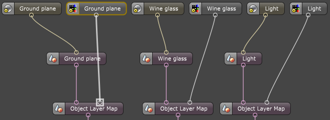

I looked at this tutorial:
viewtopic.php?f=51&t=44267
Which shows how the node setup should look:
But when I try and do the same a node plug is missing:
How do I use an object layer node correctly?
The Object Layer map doesn't have any attributes so I'm kind of at a loss as to how I'm supposed to connect the Object Layer node to it like in the tutorial.
Posts: 10654
Hi leehenshall,

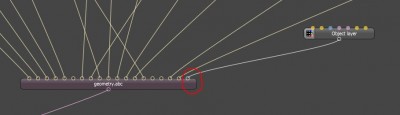

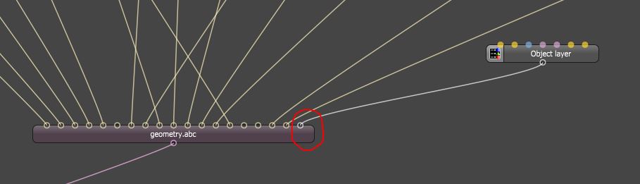

the issue you are having is that the .abc node does not have the Object Layer option active.
As you can see, after connecting the Object Layer map node, no pins are displayed.
Woth an .obj node you would not have this kind of issue, but with .abc, this could happen.

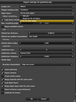

You could try to force the creation of the pins, by changing the setting in the .abc node preferences:
ciao beppe
leehenshall
Posts: 184
Joined: Sun Oct 25, 2015 5:44 pm
Location: England
Thanks for the fast response :)
You are correct. OBJ does work just fine.
I can't seem to get it working with ABC file though. Even after changing the import settings as you have suggested. This could be a problem if I needed to use and Object Layer Map with geometry that is animated.
Are you able to offer any advice on getting ABC files to create pins on Object Layer Maps. Could there be something i need to do when exporting my Animated scene files from my DCC app? I own the Maya and C4D plugins if that helps.
Posts: 10654
Hi leehenshall,
it surelly depends from the Alembic exporting settings of your host app. But if you ownnthe c4doctane plugin, you can directly export your animated object to Standalone in .abc animated format from Live View, and the Object layer node should be already created.
ciao beppe
leehenshall
Posts: 184
Location: England
Ohhhh wait I think I get it now. For Alembics the Object layer map is in the Alembic node and you don't need to use an Object Layer Map.
Using the orbx scene exporter as you say will also provide this plug in the Alembic node. Or if you import a normal Alembic and you select "pin for each object" you will expose the additional Layer Map pin.
Is that correct?
