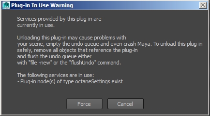

In Maya I would normally go to -Windows>Settings/Preferences>Plug-in Manager and unload it from there.
When I create a new scene and add nothing and load Octane and then try to unload it again this gives the following error:
If I click "Force" Maya crashes.
If I delete the octaneSettings node and flush the undo queque before trying to unload the pop-up doesn't show but Maya crashes.

The only way in Maya is to uninstall the octane pluggin

That doesn't work.
Octane remains in the scene file. Just doesn't load anymore.

just saving the file again in binary format (mb) should get rid of the octane nodes, but if it does not, go to : File>Optimize scene size> remove unknown nodes > remove now
