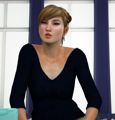

Thanks to the Herculean efforts of one bepeg4d, I have finally I managed to pull my alembic file in, attach it, and watch her dance. Before the applause died down however, I noted another issue. Frickin' motion blur. Seriously *sobs quietly* -- Okedokee. Why is a motion blur there and I have turned that feature on? Why is she blurry? Any remedies for this...?

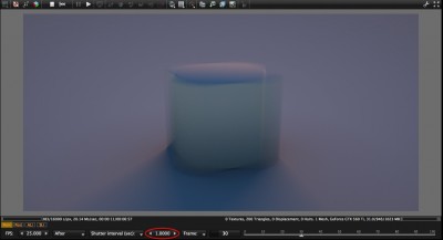

no worries about motion blur, it's easy to get rid of it ;)
In the left side of the info bar in the render viewport there are the animation settings, basically the shatter interval control the strength of the motion blur effect:

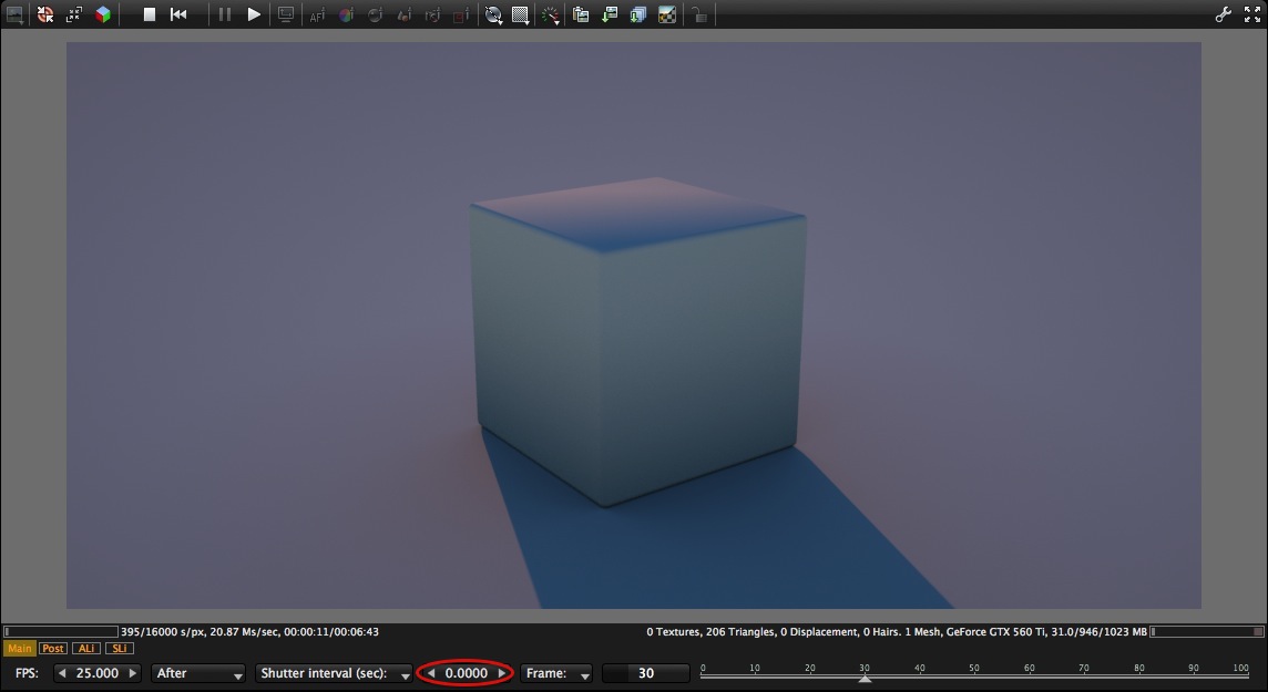

just set it to 0 for removing completely the effect:

Most certainly, but there is one more small need I have and then I will mark off--the textures look kind of odd on the alembic--esp around the hair, neck, and arms. Not sure why this is occurring...after this I'll sign off, as I am sure my next load of questions will be render related--lol. :-) :D :)
WIN 10 64 | Geforce 970| 16 GB
Posts: 10591
Weird, it seems that the bump or normal maps power are completely out of range. Octane is very sensitive to the bump value, try to lower it at 0,1 as a starting point :roll:

Could it be due to the scaling conversion...I put the maps on after essentially shrinking the alembic obj down to size...?
sikotik13
Posts: 270
Joined: Thu Feb 20, 2014 6:21 pm
Location: Iowa, United States
Scaling conversion issues would make the maps appear squashed or tiled or otherwise out of place along the "plane" of each surface. The issue you are seeing is the values affecting how deep the maps appear, which is, as bepeg suggested, pretty much always a value thing for the bump/normals. Try lowering them 0.1, maybe even lower. I've often found 0.05 to often be adequate, depending on the maps used.
