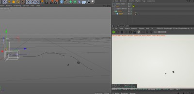

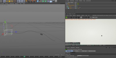

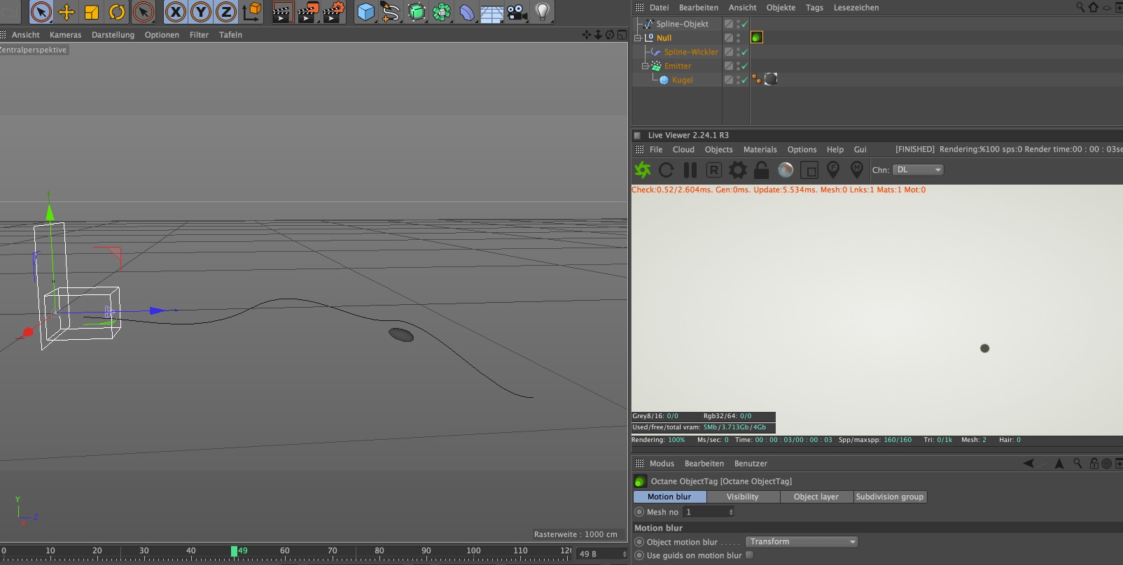

I use an Emitter in combination with a Spline Wrap Deformer. In the the Cinema 4D (R16) viewer everything works fine. Unfortunately the Octane Live Viewer (2.24.1 R3) just shows the emitting particles without being affected by the Spline Wrap.
If I use e.g. a wind effector for changing the direction of the particles it works like it should - the Cinema Viewer and the Octane Live Viewer show the same.

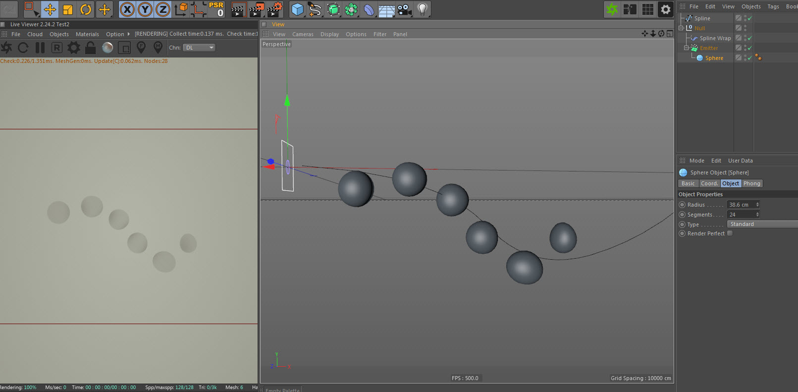

Update detection problem. It can happens with virtual generator objects(Sphere, Box, etc.. under a emitter, cloner) + complex setups(like here).
I think it's not possible to fix without break something on current system. Otherwise we will loose some other advantages on update detections. Anyway i'm checking.
Solution: Convert your sphere to polygons.
