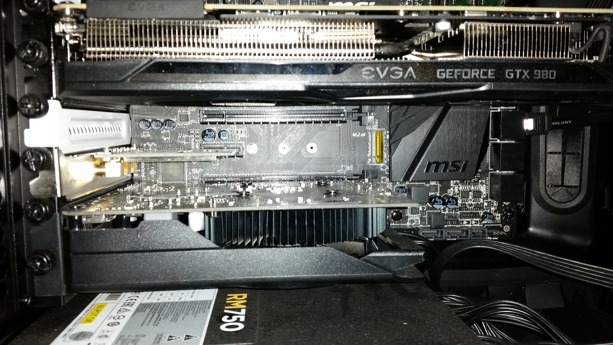

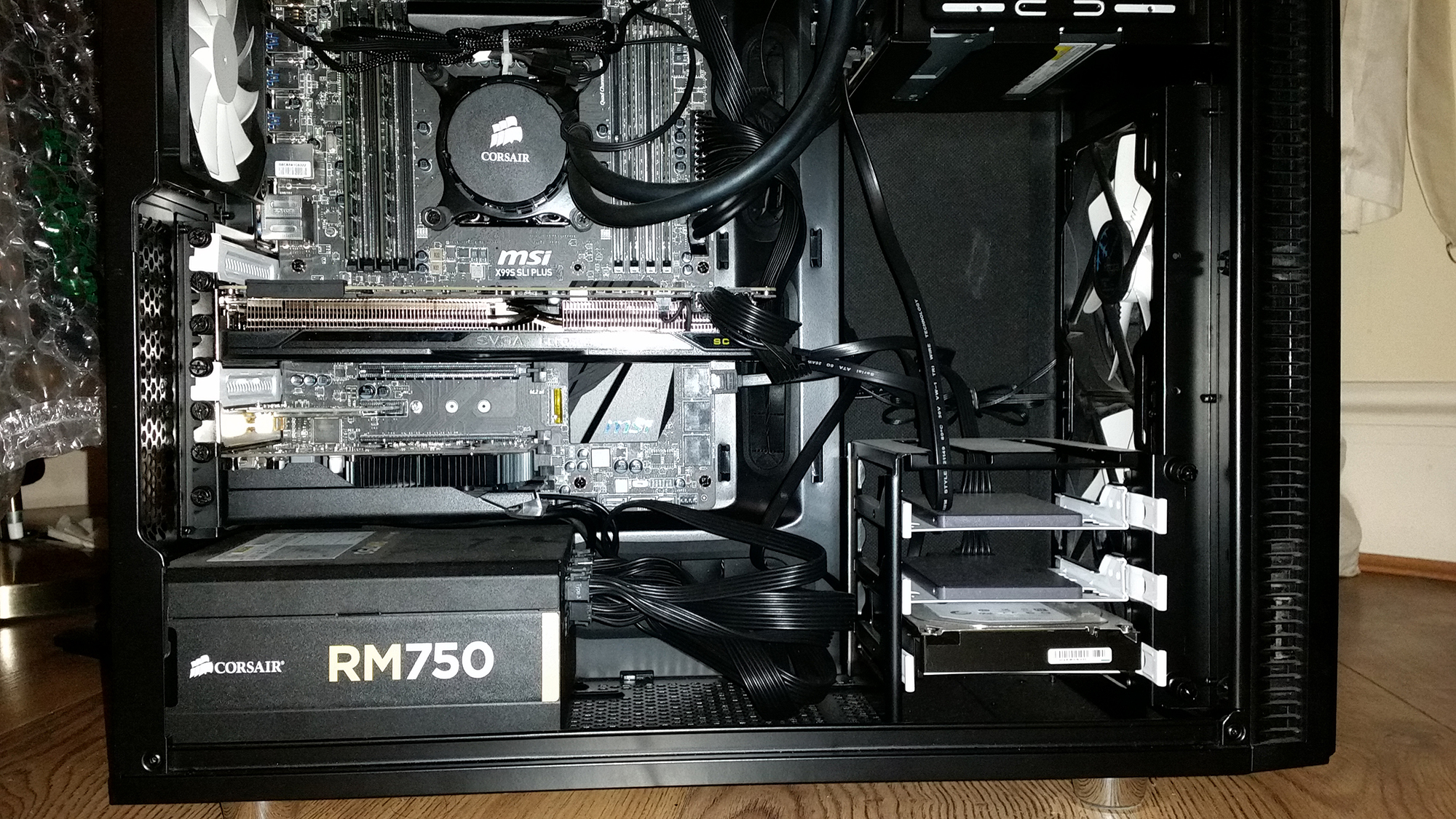

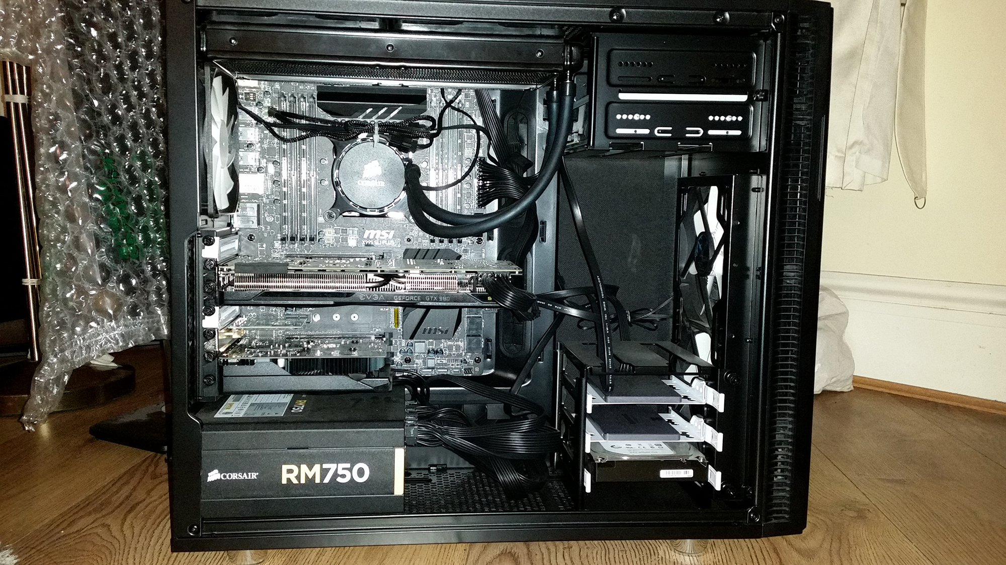

Thanks for the input dude, sweet that you got 4 980Ti's man, super envious, I bet that runs like a dream.
I've attached pics of my set up, and by shifting the 750Ti to the lowest PCI-E slot and the wireless card to the one that the 750 Ti currently sits in, I think the new 980Ti Hybrid should fit in the free slot beneath the 980 that is in there already, with the AIO fan mounted to the base of the case.
As you say, it might be a rather snug fit.
Alternatively the second option is the 750 Ti goes underneath the 980, which will free up a bit of breathing room for the 980, as the 750 is smaller in length, and the 980Ti can fit in the lowest slot.
My third option is the cast out the 750Ti, whilst it is handy to have as a display card, it might be excessive and space consuming. Especially if my wireless card is forced out.
Win 7 64-Bit | Geforce GTX980 & GTX750Ti | i7 5820k | 32GB RAM

I'll give you my recommendation, but ofcourse everything is up for debate. Wall of text incoming....
The way I see it, you should keep the 750 Ti to create image in Windows so the other cards can focus on rendering. Windows really doesn't like when you are rendering heavily on the card that is making the UI image, in my experience. I've had issues where I let all 4 cards max out on the rendering and then when I went away to play some Xbox, I came back to find that the UI output for Windows went fully black and unresponsive while the cards remained fully active (fans kept going pretty hard). Now I just set up the UI card in Octane to throttle the render, and then I just put up a movie onscreen while it renders...and it all works great. So basically you will get a little more power if you keep the GTX 750ti while the rendering cards are both going 100% without problems. It's also better to work on that GTX 750ti I think cause it consumes very little power when working in your Windows apps.
I'd put the EVGA Hybrid card on top cause it has a cooler like the nVidia one, so it won't have problems when there is another card right below it. That would be the GTX 750 ti. Then when the 980 is on the bottom, it can benefit from the gap between the card itself and the PSU to breathe
And I'd get rid of the Wireless card... can you use powerline in your house?

Currently I cannot wire the net thru as I don't have an access point. But I'm getting one put in.
I think you're layout makes complete sense, and is likely to be the way I go.
Gonna need a new psu to account for the three cards, but I figured that would be the case.
If I only I had foreseen that octane would be so great, my build last year would've been accounting for extra room and more importantly on board wifi.
Thanks phantom, your input helped!
