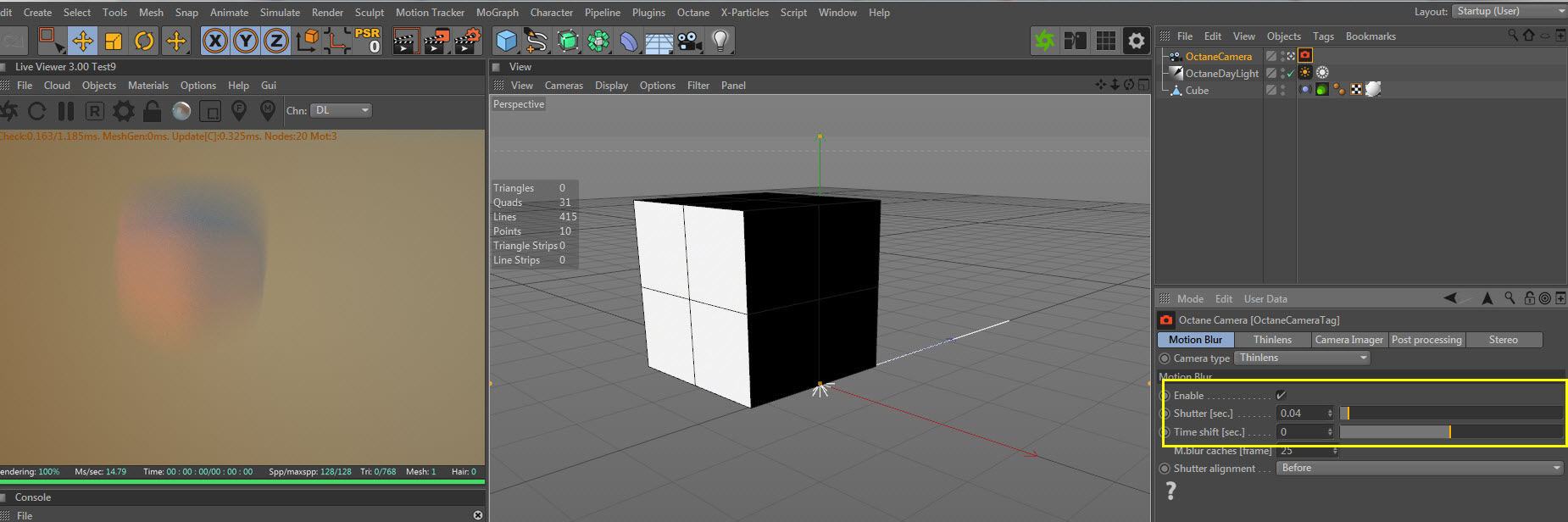

Sure, I am unable to attach the actual scene due to client rights, but here is a simple one that does not render motion blur or sub d when all scene data is sent.

Please notify that Motion Blur section in Camera. Also "Send All data" is not supporting object motion blur, object layers, object based texture spaces, etc.. I should rename it as "Export all objects as a big static mesh". I hope that's making any sense.
Yep sorry i know about the motion blur camera option, i neglected to add it to the simple scene. I was hoping the subD would work. I was mainly concerned because I have been finding that the only way I can get the same EXACT animation through octane is to use Export All scene data. If I do any other, I find that my animation is not quite the same (sometimes very close, but slightly different) when using deformers or effectors like delay, jiggle, random, etc which I use a lot of in my animation. I now understand the 'Export one giant mesh" hehe. Thank you for that.
