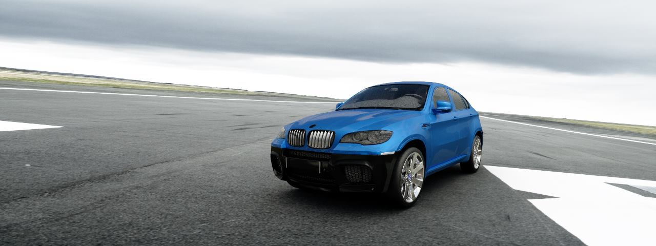

What I meant was, in older versions of octane there was a floor shadow that was projected from the object when using HDRi's. I didn't have another object there to catch the shadows, like a plain object or other types of geometry. This was back in the Octane 1.0 days or something like that. However, now, in the latest build, it seems like I need to have geometry under my object in order to catch shadows. So, I guess you can say it was a fake shadow.
I'll upload an image that I rendered with an HDRi in octane awhile ago, to kind of show what I am talking about.
The only object in that render is the vehicle, the nthe HDRi for lighting.
Shadow under object
Shadow under object

Make a large plane, and assign it a diffuse material. Then turn on "Matte" in the material properties.

Or switch to the new render layer system, look at this tutorial (in particular the part 3), it's for c4d but the same principle is good for standalone or any other plugin:
http://inlifethrill.com/trainings/octan ... rendering/
