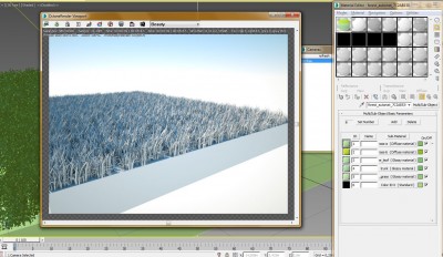

am i'm doing something wrong here?
i have added forest pro grass, edited the materials - but the grass stays 'gray' :-/
forest pro version 4.4.1
octane standalone 2.24.2
octane plugin 2.24.2 - 2.9

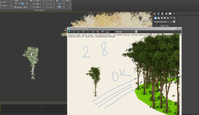

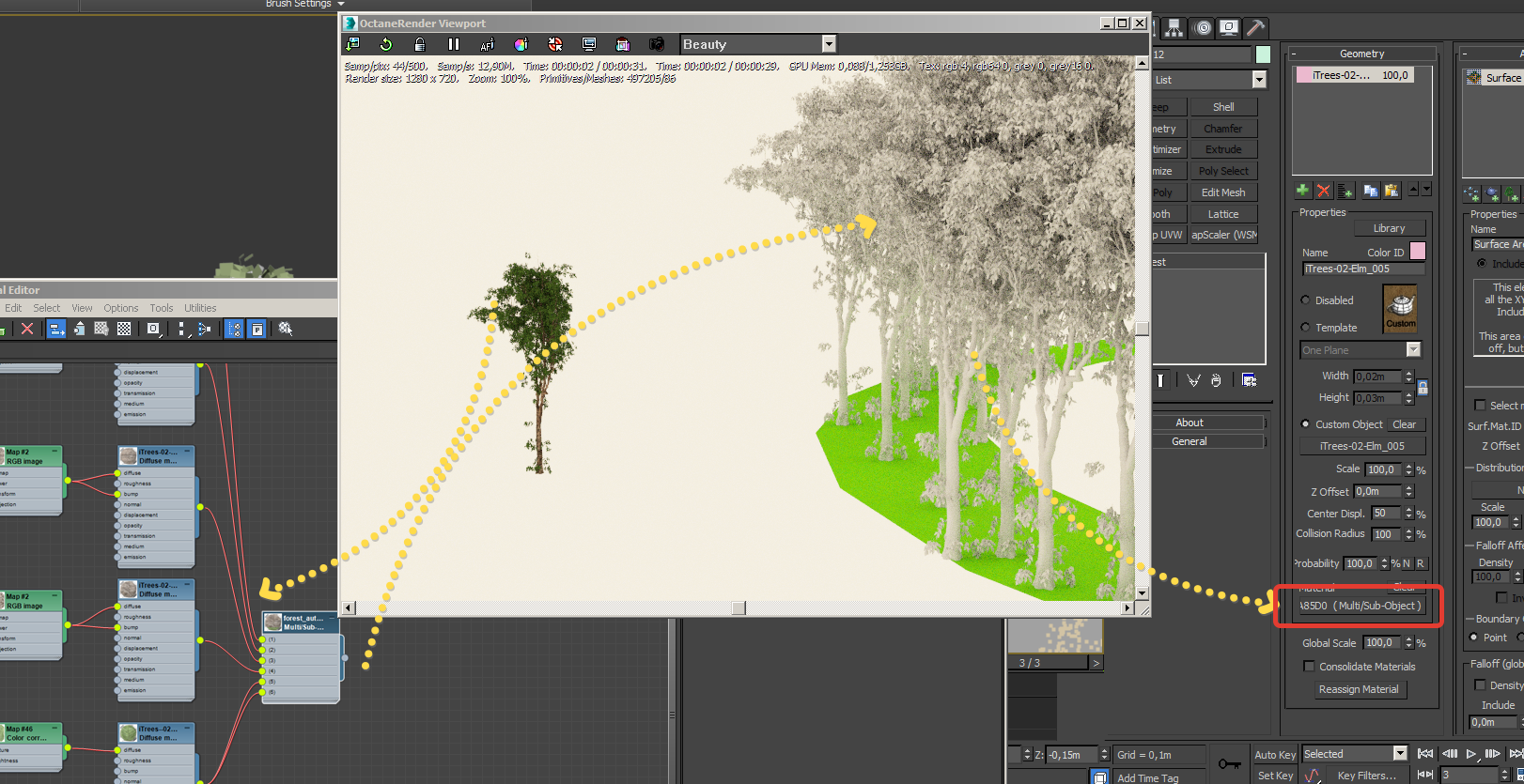

most likely the error here
does not support correctly multi materials standard

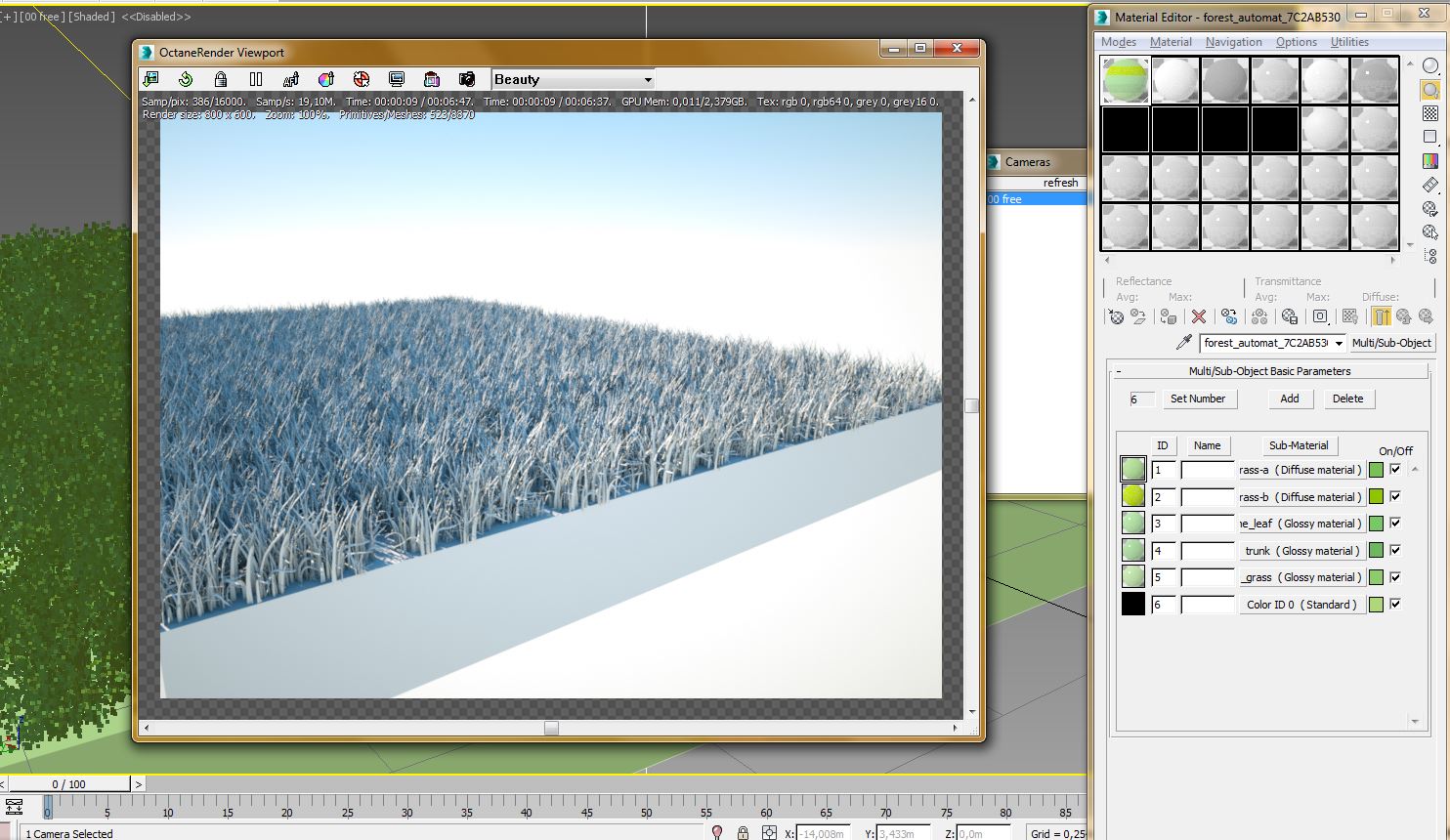

@goldisart
could you please explain? :-)
i have added grass, selected the material, changed the material to diffuse material - but as soon as i refresh the octane window, the material gets reset.
i then change the material on the custom object, but that seems to have no effect :-/

JimStar
Posts: 3816
Jorgensen
I'll check it tomorrow. Your problems may be due to Octane plugin does not understand the multi-material set to Forest geometry... I'll fix it if this is the case.
