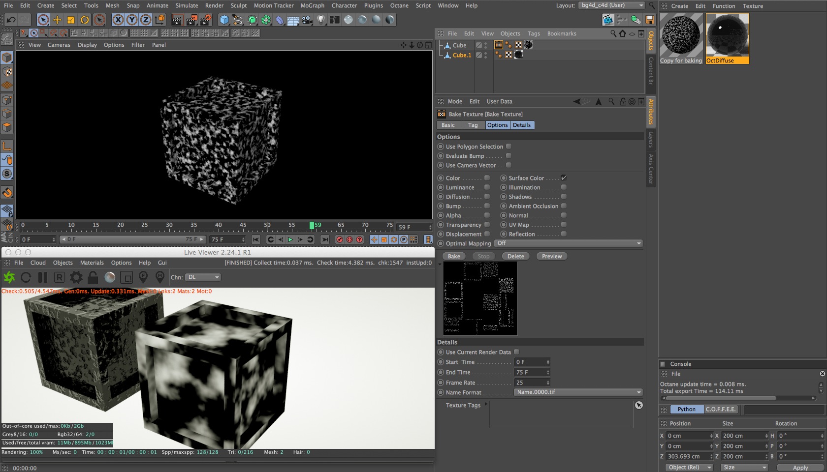

Posts: 10466
if so, why not backing the various shaders and then, apply it as animated texture to the octane material?
BakeText.zip
(111.21 KiB) Downloaded 163 times
ciao beppe

Posts: 10466
obviously it depends from scene to scene, but, in my experience, backing the procedural texture could speed up the animation rendering a lot, if you can, give it a try ;)
ciao beppe
