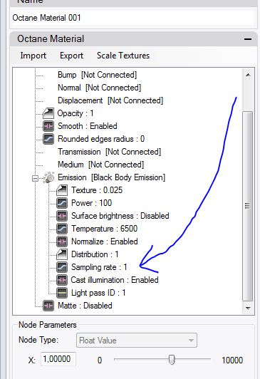

Hi
There is a setting for emmisive node called sample rate:
From my experience what it does is allocate more samples to that particular emmisive (light source). It doesn't multiply samples, it simply make chosen emmisive to be more important in calculation.
This should help evening up the noise. Try fiddling with it and you will instantly get the idea.

I think its option 1 - and it is relative - sampling rate works like importance in my opinion.
I usually tweak this setting until I get nice results - there is no perfect formula i think
