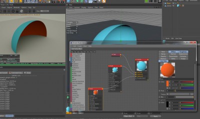

here is the image. sorry. it is a converted plane with 2 materials on the object, one front, one back
Posts: 16066
Location: Türkiye
We just support one material assign to per triangles. But you do it by this way.
