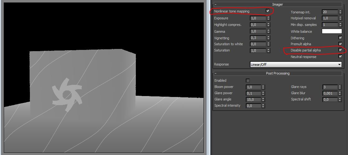

Posts: 10654
Hi guys,
please, could you retry with "Nonlinear tone mapping" option active to not see the Z pass only in black and white, and the "Disable partial alpha" option to remove the anti aliased pixels:
ciao beppe
