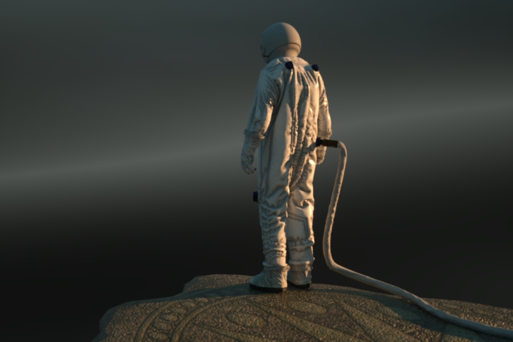

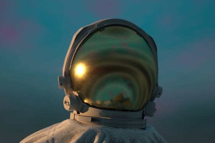

Hi Kibby,
here is a first attempt of a space sky using only octane procedurals and exported by DAZ:
Space-sky.orbx
(6.97 KiB) Downloaded 252 times
And here is a couple of renders:
In general, the environment texture controls the ambient light, in this example you can change the power of the Ridged Fractal node and or the power of the Marble node.
I hope it could be useful for you,
ciao beppe
