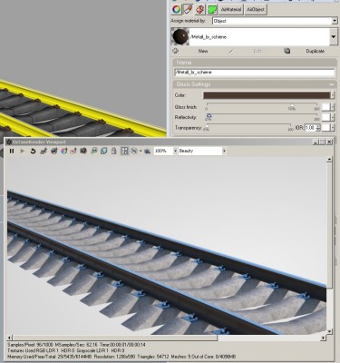

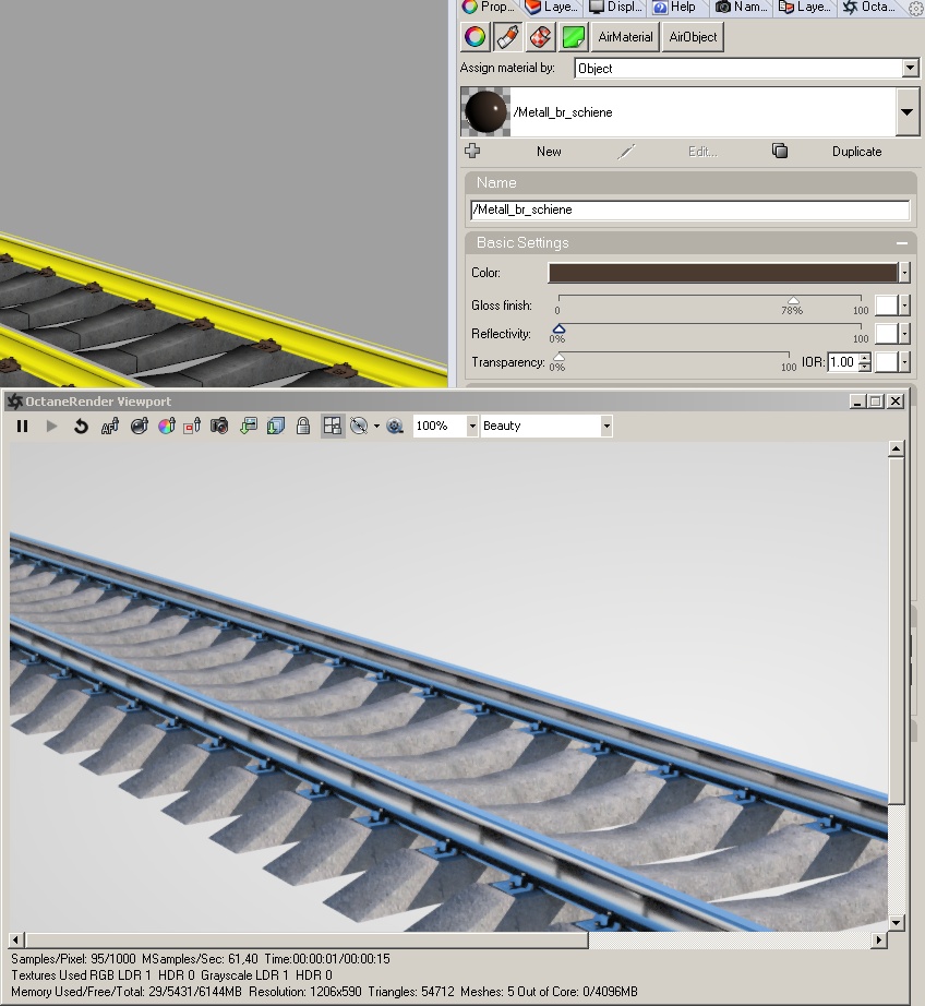

Here an example, the rail with Reflectivity o% should be looking like 2% and not like 95%.
Reflectivity=0%
Reflectivity=2%
Reflectivity=95%

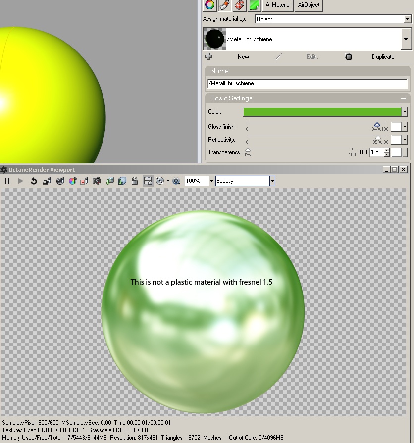

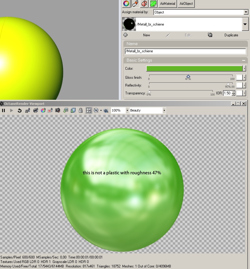

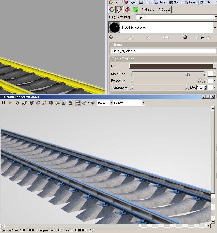

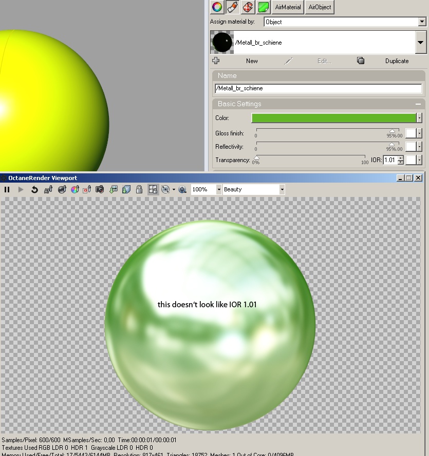

I did some more tests and it looks like the Rhino material connection is complete buggy. Here some examples:

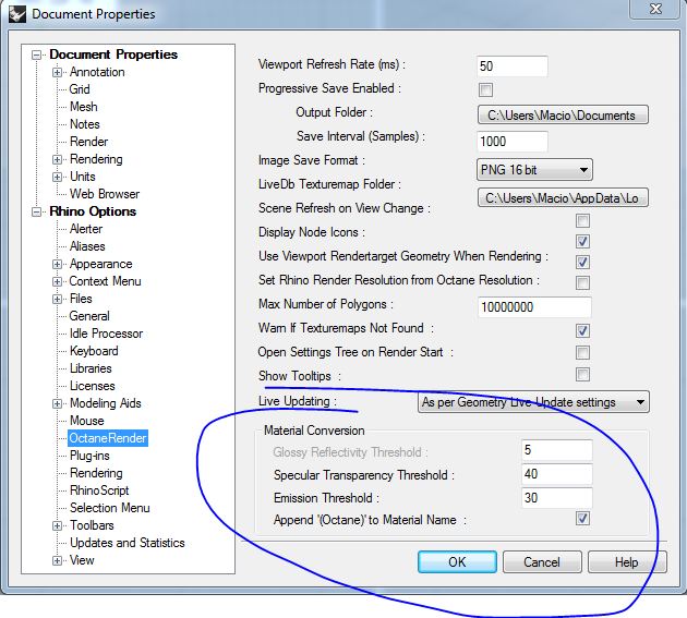

I think Micha refers to rhino materials and their appearance and behavior during render in octane.
Micha have you seen this:
Micha
Posts: 122
Joined: Sun May 30, 2010 4:49 pm
Location: Germany
And so you get control over roughness, IOR, reflectivity so that a material looks like a rough plastic? I tried it but it doesn't help. Also I can't disable the "reflectivity 0 will cause full glossy" behavior that cause the wrong look of materials with reflectivity 0.
