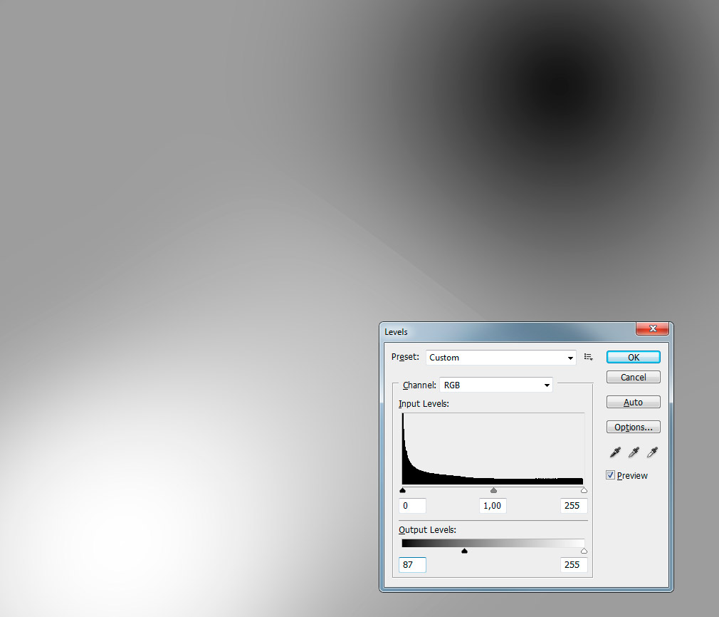

It's really a tricky and poor solution but you may play with Levels > Output Levels in Photoshop (in my old Photoshop CS 5.1 it works like that, maybe there is new possibilities in newer version). By moving the black cursor to the right, you'll compress intermediates values and should be able to restore the negatives values to the positive side. It a poor solution because you'll loose intermediate values, but with 32 bits it should work...
I'm also searching an utility to convert signed Bitmap to unsigned. It should be probably a far better solution in this case... If someone know a solution, i'm interested... :roll:
