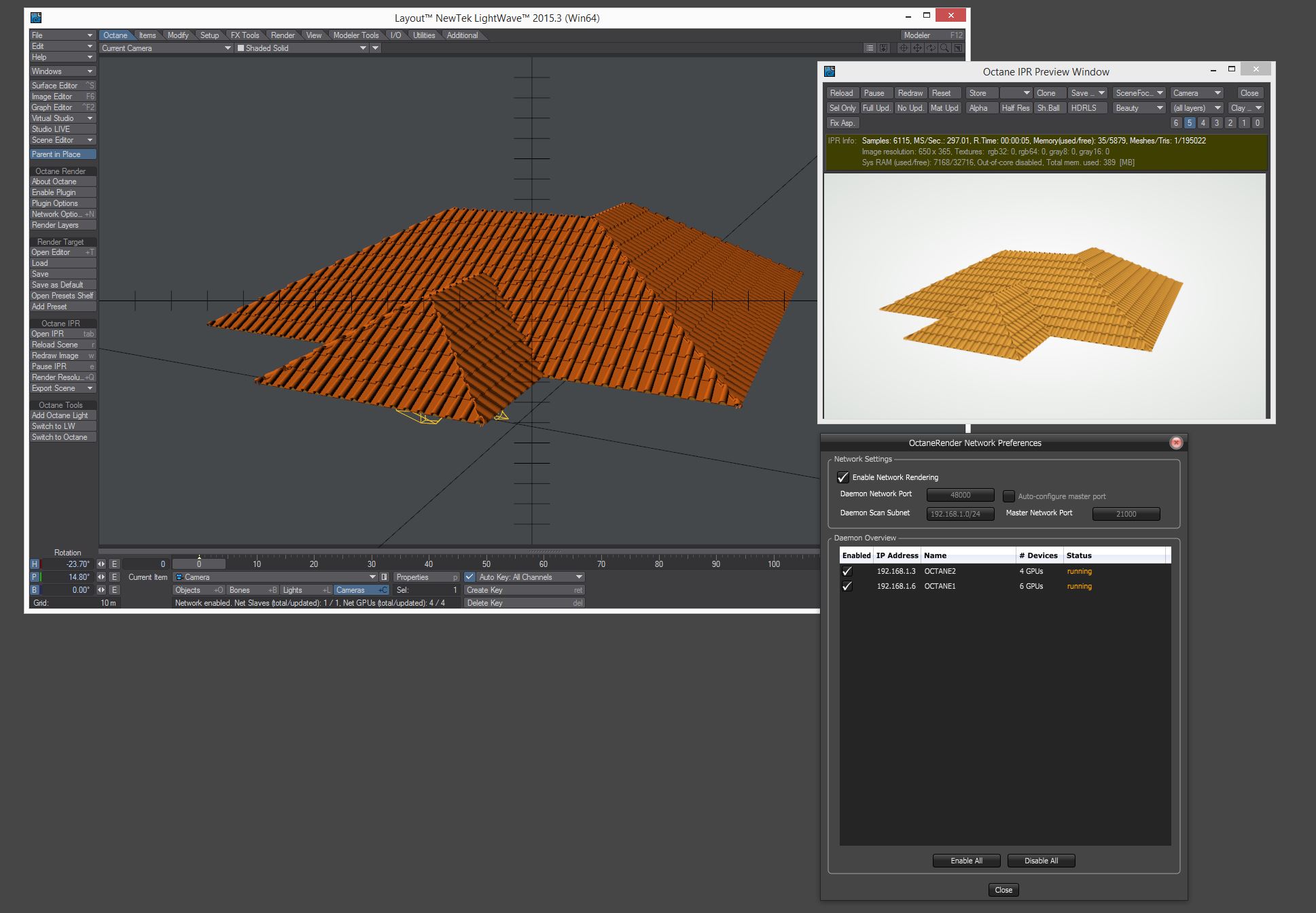

There is a problem with node recognition. As you can see here both nodes are selected but only the first one works. To make it work I first need to select the second one, start rendering and then activate the first one for both nodes to start working.

If you want to run two masters on the same computer you must have the option "Auto-configure master port" enabled. The reason is that only one process can use a specific port. So if you disable the automatic port selection and use the same port (default is 21000) on two masters, only one master will get the port and the other won't and with that no slave <-> master connection can be established on the that master. If you enable the automatic port selection, that master will look for free ports and take the first free one it can find.
If you want to use both nodes, you will be using 10 GPUs, if your master uses more than 2 GPUs (makeing the total number > 12), one of the slaves will not be enabled. If you've got a log window in the plugin, you should see a corresponding error message.
