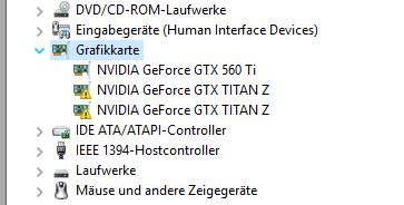

my second pc which I use as slave has a titan z for rendering with octane.
And I had (before with Win 7) a second GTX 560 Ti which is deactivated for octane but
usefull for the system or surfing in the web etc..
But with Win 10 I cannot get both cards to run.
Either the titan Z gets no driver and a yellow sign in the hardware-manager
or it happens with the GTX 560. Or the other way round.
Has anyone experience with Win 10 how to get 2 cards running?
thanks
Mike

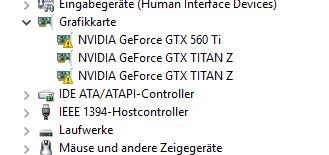

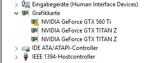

After every restart I get different info in hardware manager.
