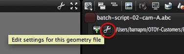

you can change the scale of an .abc node in any time from the specific edit icon in the node inspector:

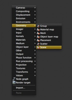

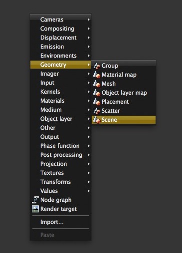

You can't use drag and drop to change a node from obj to abc, just detach the obj node from the mesh group and import the replacing abc node and connect it to the mesh group:

bepeg4d wrote:Hi,

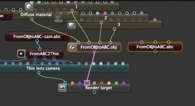

The script connect the materials only if the names of the alembic pins is identical.
you need to select both the obj, with all the materials that need to be transfer exposed as external node in the graph editor, and the abc node where to transfer the materials and then run the script.

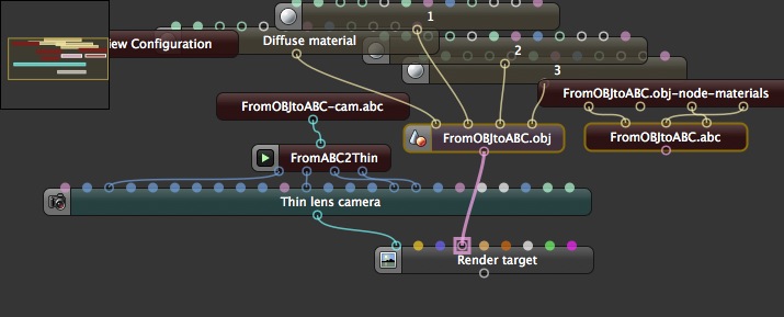

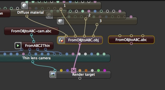

it should end up with something like this, now all you need to do is to connect the abc node in place of the obj one. I have had not so much time for testing it in different conditions, so, please let me know if you have any issues ;)
