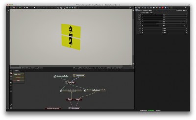

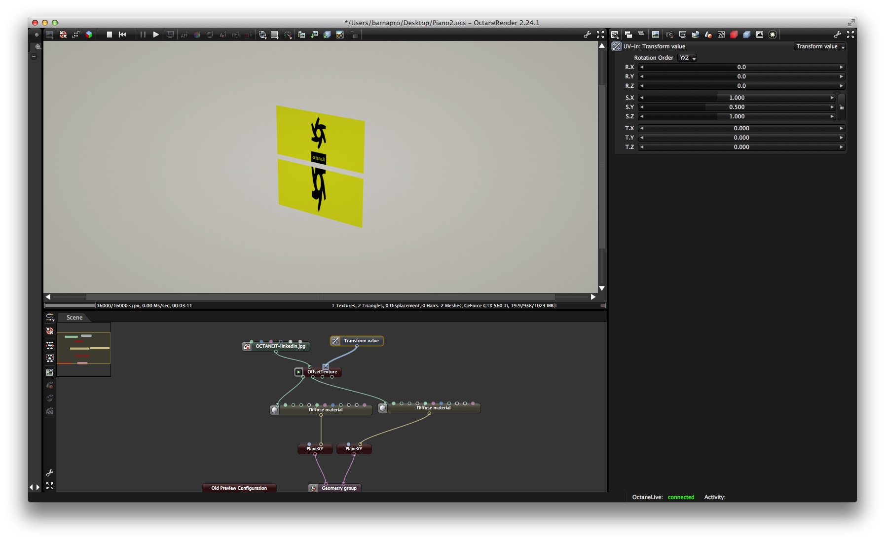

I think image explains quite well what I want to do.
That is a scriptgraph that takes an RGB image and an Transform Value as inputs and outputs a new image with the selected transform values.
From example code I have managed to figure out how to add the inputs and outputs but I cant figure out how to create new RGB Image as a copy of the one in the input.
I suppose that if I just can get some help to create the image and connect to the output then I can probably figure out how to change transform values by myself.

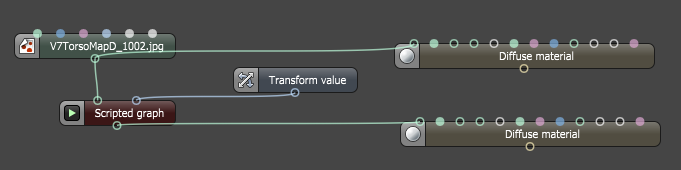

Ok, here is my attempt: It almost works as expected, If you use the first two output ports... but for some unknown reason (from me) the output ports are duplicated and inverted
Maybe you can find my mistake

Well, it works but I found a problem.
First.
Looking at the code I can't see any reason for double outputs either.
Nice structured code that will helped me understand it.
Will try to rebuild it from scratch later on to see if that will help me figure out why and when double outputs appears.

Problem is that when i reload the project, any connections made from the outputs to my materials are lost.
Same happen if I select the Scriptgraph and press refresh.
Any ideas?

After fiddling around a little, mostly not really knowing what I did I did manage to get rid of the duplicate outputs, connections are no longer lost on project reload.
I'm not sure what made things work better.
The real mystery is that I tried to connect input[1] to output[1] but got did it wrong and got some errors so I removed the code part. But strangely, what's put in at input[1] comes out at output[1] without any connections has been made in code.
Is there something working behind the scenes here, that connect input[1] to output[1] automatically?
Well, I have no idea.
Anyone that knows?
I have attached the modified code if someone want to take a look.

thank you too for let me understand my mistake, now I have revisited my code and there are no more double connections
About the output 1, I guess there is any direct connection, I have revisited your code adding a Tex1 line:
