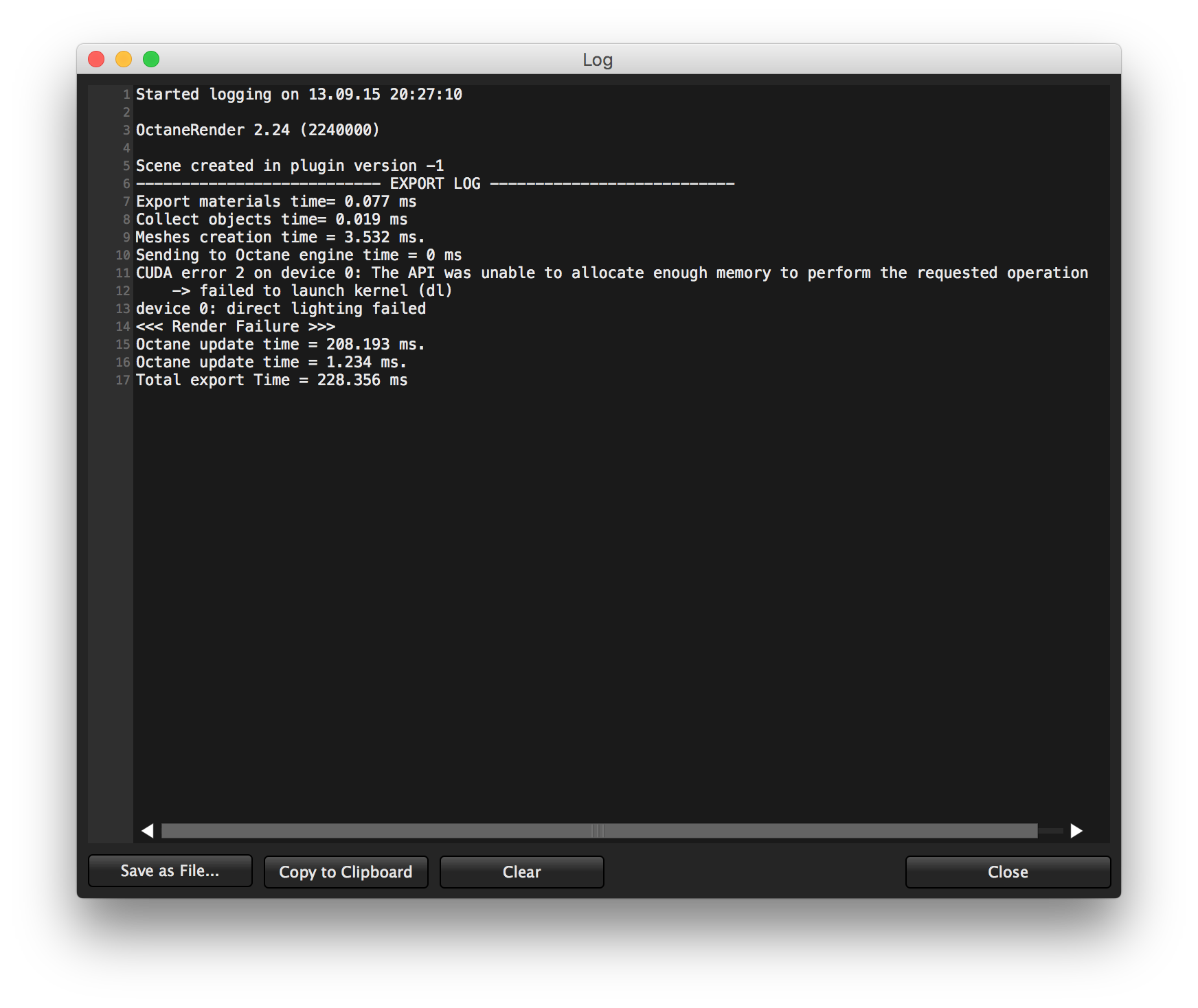

Octane doesn't work anymore. Curious if it might be related to their new 'Metal'? Perhaps there is any work around this that I can do on my end or should I wait for a patch? Thanks!
Attached a screenshot of octane log.
OSX El Capitan

I have Octane up and running on my 2011 Mac Pro, running El Capitan 10.11 with one Titan X (flashed via Mac Vid Cards).
It was a little tricky getting El Capitan installed and working with the Titan X, but it is working with C4D R16. Solid performance and stable.
I had to disable the Nvidia driver prior to install, let El Capitan finish installing and boot with the default OS X vid driver, install the latest driver (Nvidia Driver: 346.03.02f01), and then finally turn the nvidia driver back on via the Terminal.
You can find some information on the Mac Vid Cards site, specifically on the blog section: http://www.macvidcards.com/blog
Hope this helps.
