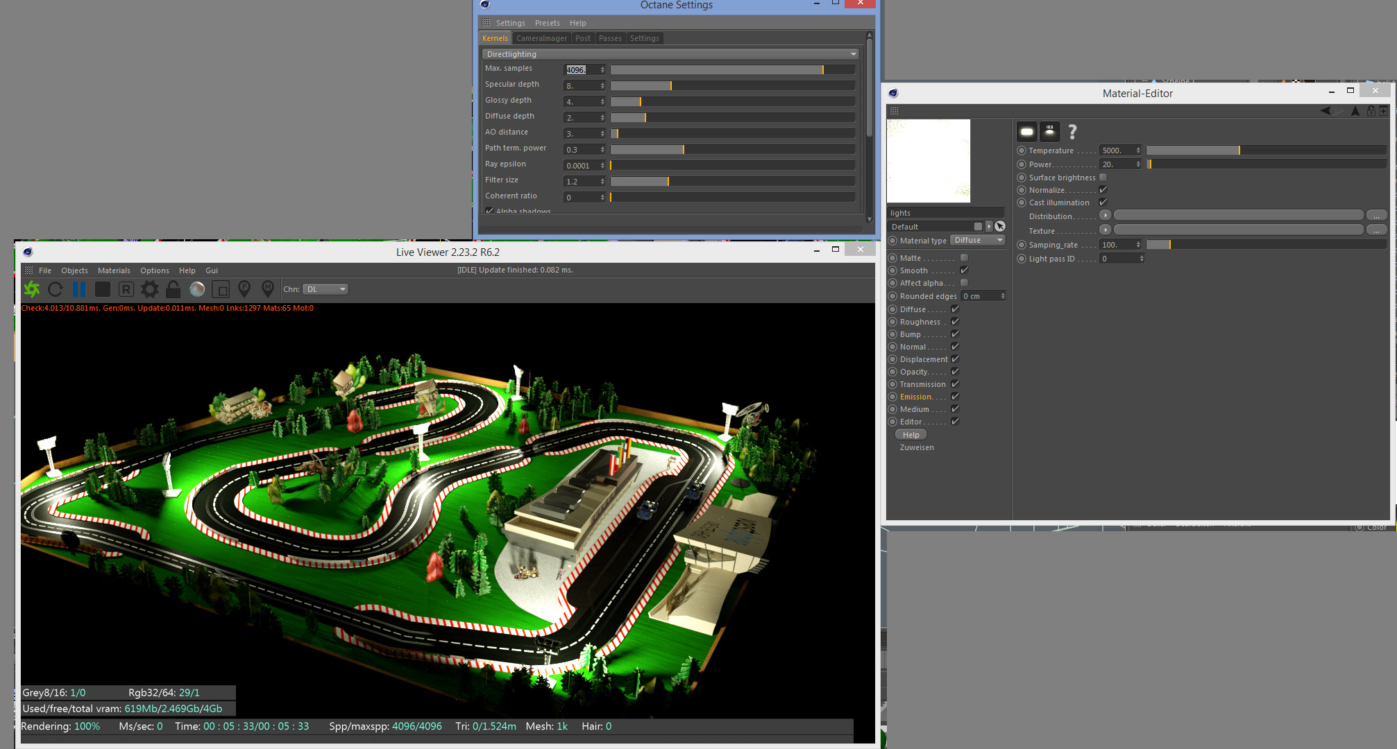

Hi there,
i´ve got a problem with fireflies in my scene and maybe somebody can give me a few tips to avoid them as much as possible =/ (cranked the samples up but doesn´t really effected it)
Don´t know if im doing something wrong or if this is just a "common" problem?!
My light comes from a few planes with a blackbody emission texture!
I would be very grateful for any kind of advices!
greez armin
Posts: 16068
Location: Türkiye
PT is more efficient for this kind of scenes. You can easily elliminate them by GI_CLAMP and coherent ratio.
