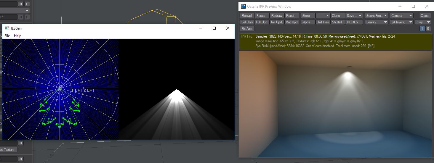

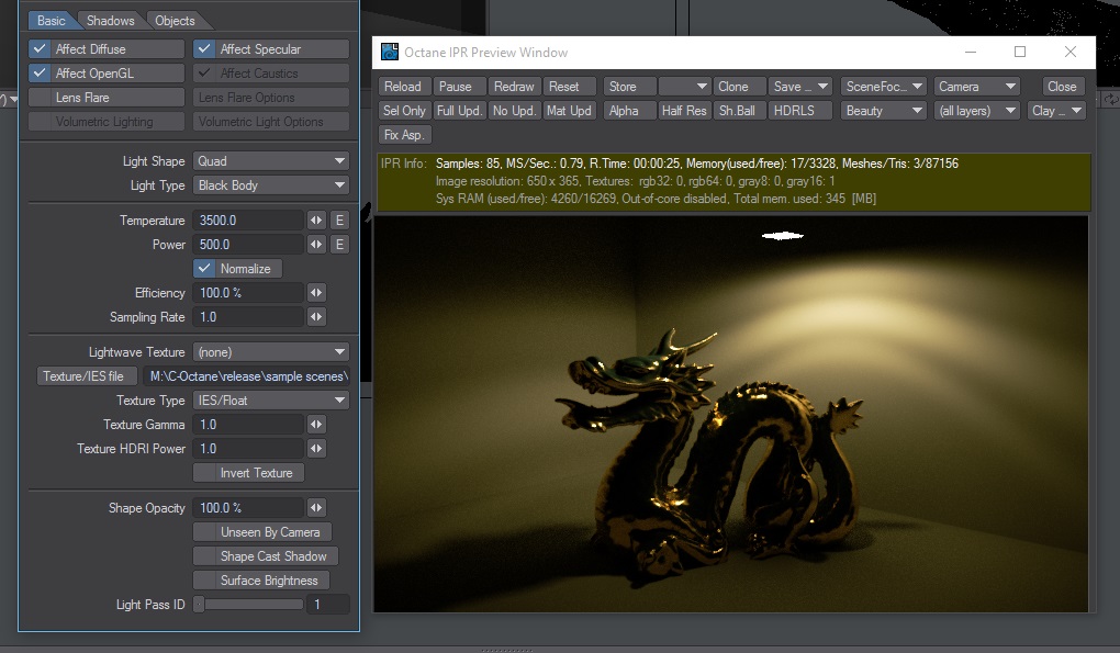

I'm working with IEs lights more and have found another question. Working with IESGen V4.0 I create lights. Then when I pull them into LW/Octane they show up close to what they should (each render engine is a tad different I understand) But the weird thing is I have to INVERT the texture/IES within the properties panel to get the light show on the generating poly (in this picture see it's dull/not lit) But inverting the IES properties is not a good solution as the light is different. What am I doing wrong with IES Gen in making new IES files?

Are you using the Octane light? ... at least here the Octane light seems to work fine with the IES files. If you are using a mesh with an emission node, perhaps you should try to invert the polygon normals to see what happens.
If you want to share a test scene, I could test it here.
-Juanjo

Juan...I think it must have something to do with IESGen and the files it's creating that need to be flipped/inverted. You may test your self so you can see the file you create and what it SHOULD look like. I have other IES files I've downloaded from MFG's that seem to work fine.
