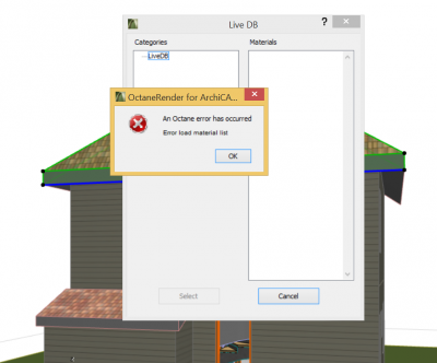

I've purchased Standalone 2.x and Graphisoft ArchiCAD Plugin 2.x. To my surprise, 2.x plugin doesn't support 16x ArchiCAD though it is listed as supported when purchasing, so I come along with 1.5x version with which I have following issues:
1. When trying to download LiveDB material, ArchiCAD 16 have kept crashing though I could search for material in LiveDB, and now it just can't load any LiveDB content.
Is ArchiCAD actually crashing, or is the plugin just popping that msg? That message indicates that the plugin detected that the OctaneLive servers (which host the LiveDb) were offline. There have been a couple of reports of this problem - and Otoy are currently investigating the issue.

Installation of the latest release have solved all issues with plugin.
