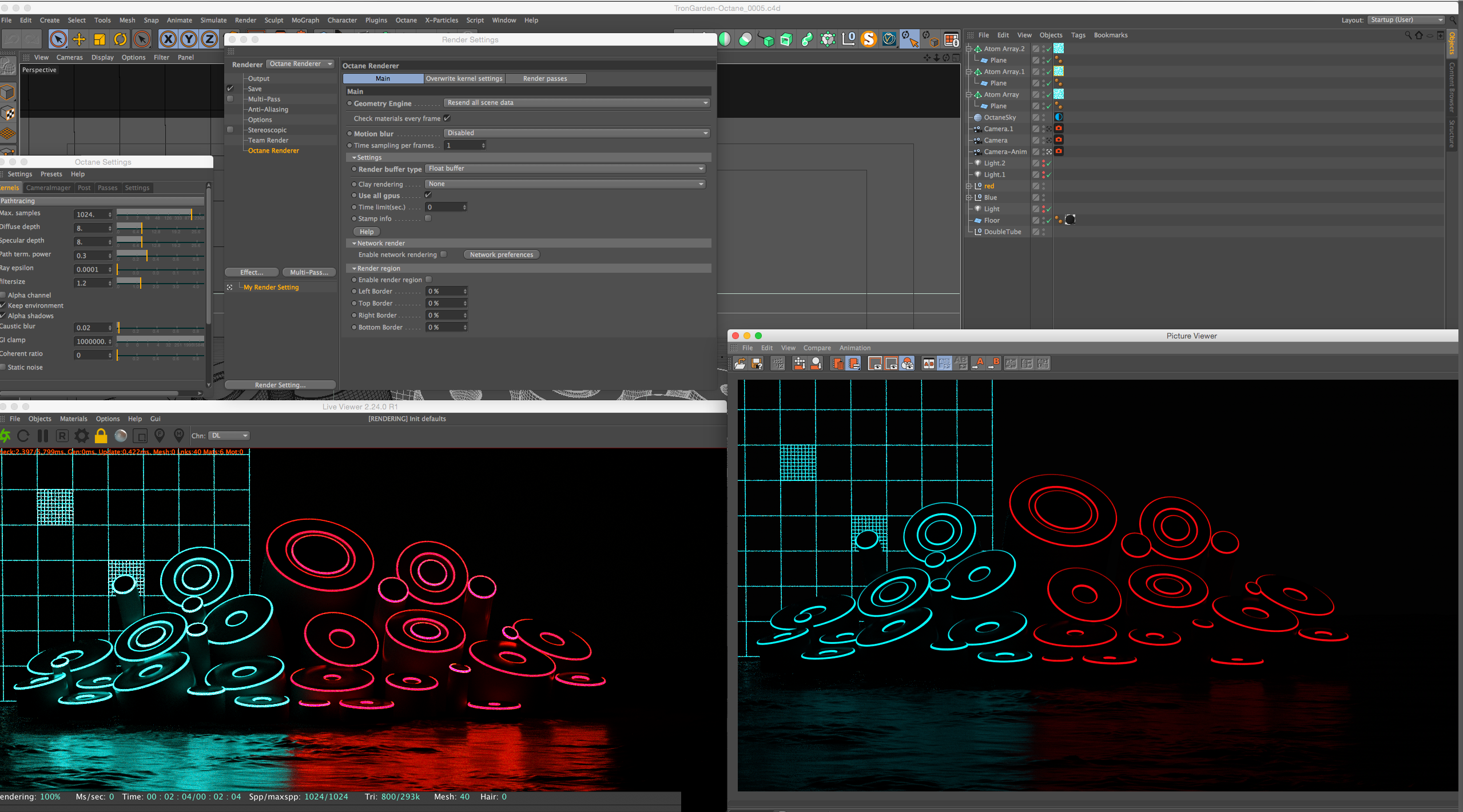

I am running into a problem where my scene lit entirely of emissive textures looks great in the liver viewer, and much darker in the picture viewer.
I know I can change that in post, but I'm wondering if I could get what's in the live viewer into the picture viewer to be exactly the same.

Looks like it's due to geometry engine.
Resend only updated objects looks right
Resend all scene data produces the much darker image

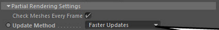

One thing in the FAQ is that my Mac render settings do not contain partial rendering settings section with the update method dropdown (see attached)
