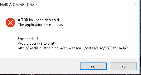

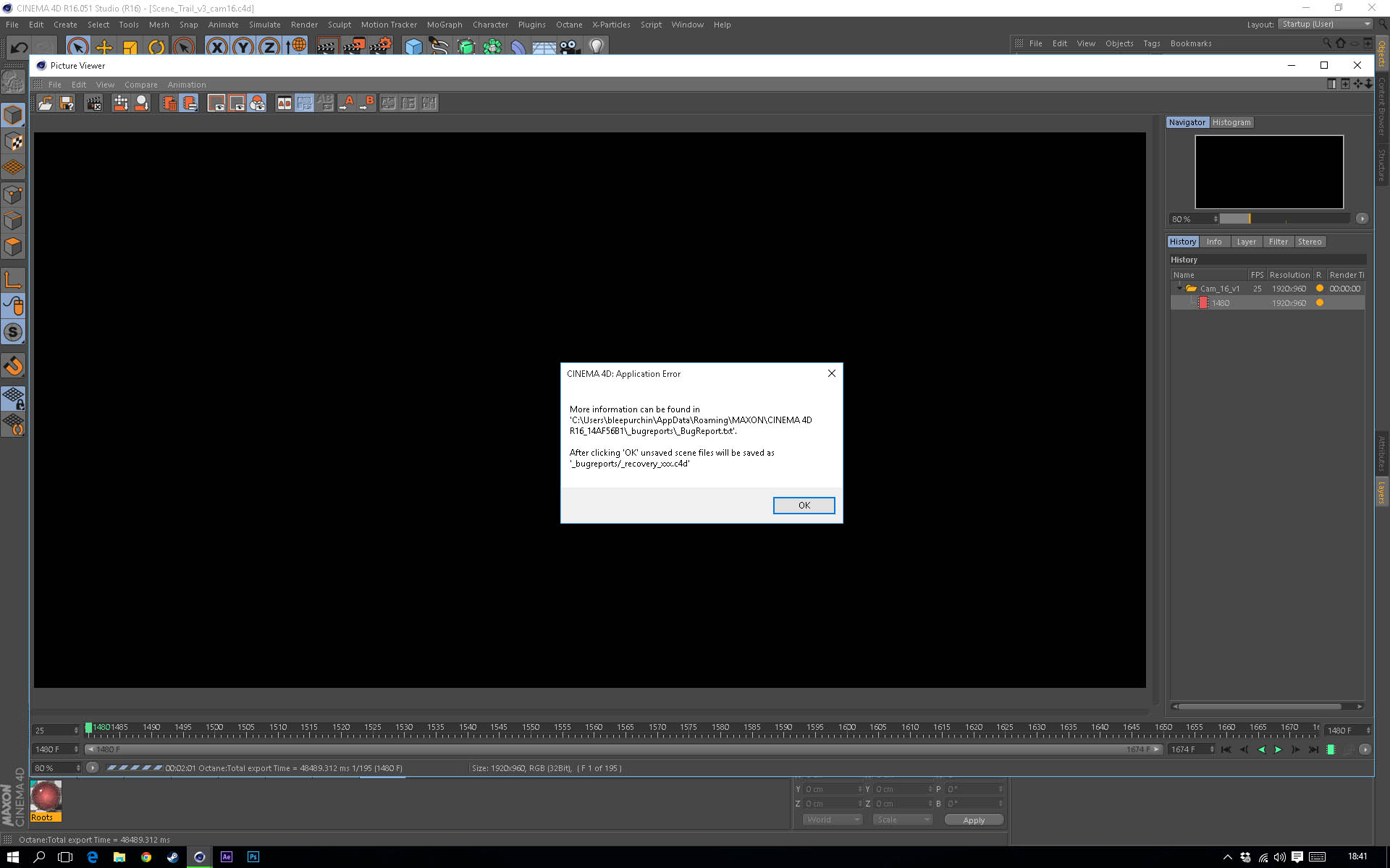

I have found that on smaller scenes the three cards work great. However on this larger scene I 'm working on now I cant get the three cards to work without this error appearing and C4D crashing:
Screenshot (7).png (10.36 KiB) Viewed 3165 times

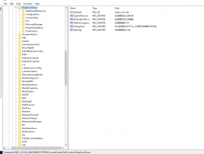

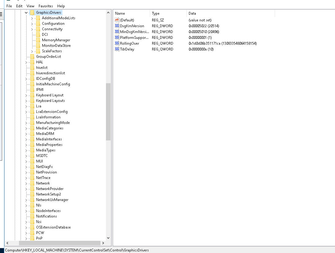

I've changed the TdrDelay from 2 seconds to 20 which hasn't helped:

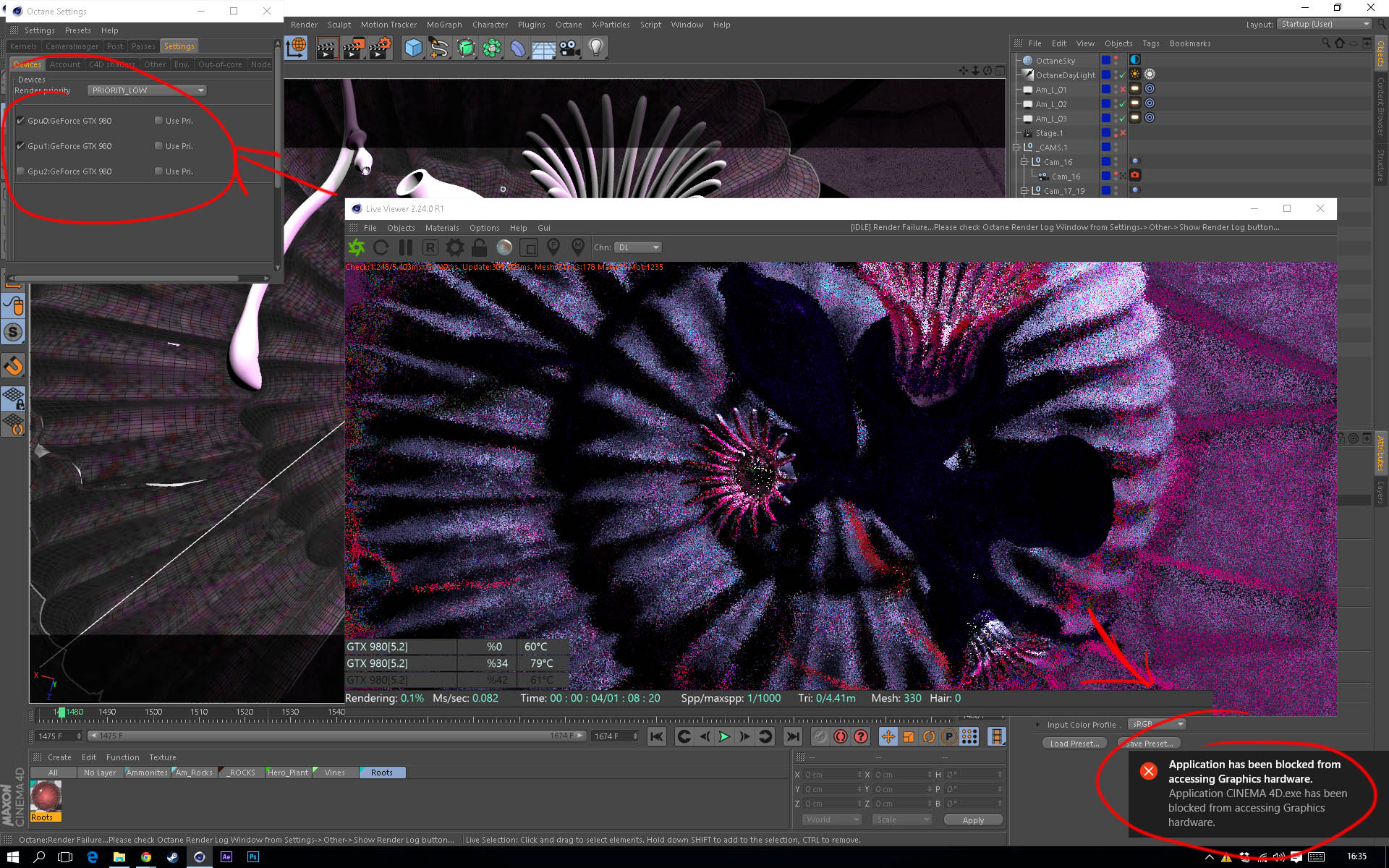

If I only use two cards the problem doesn't seem to occur when using C4D picture viewer but it does occur when using the live viewer and I get this windows message (bottom right). After this message appears the viewer becomes inactive:

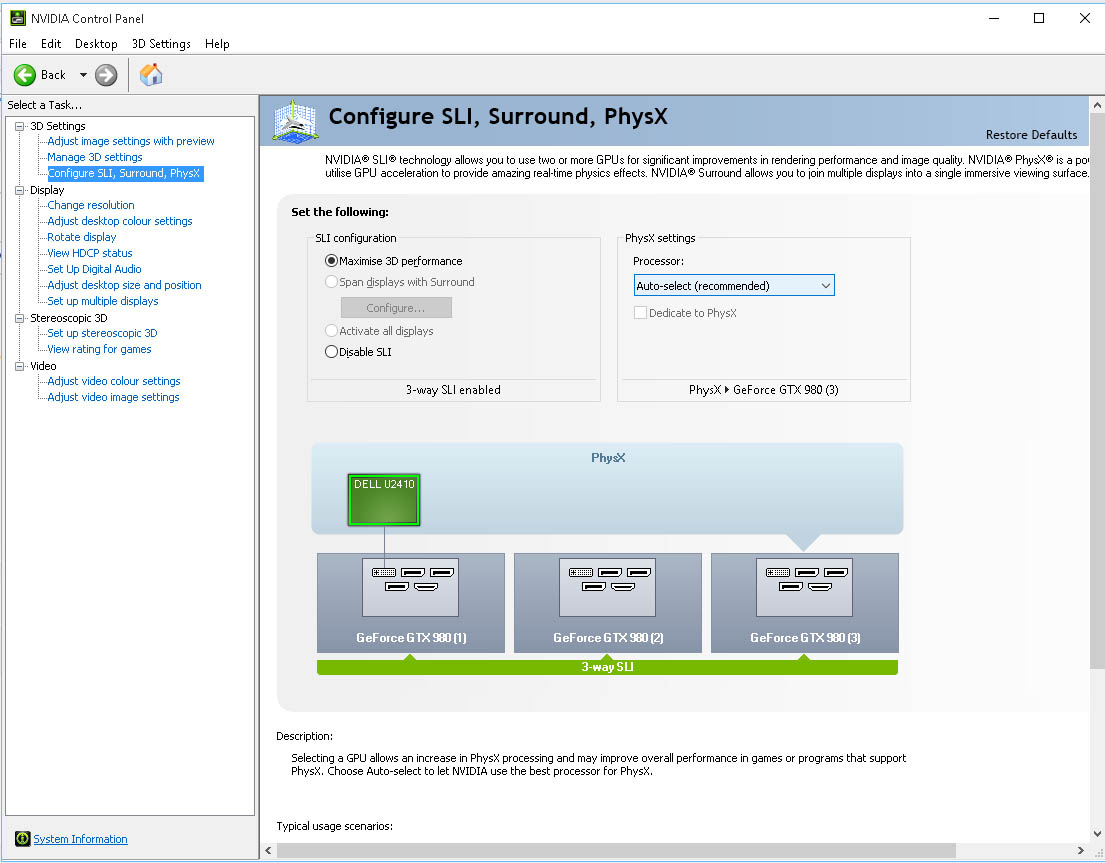

Great feedback. Do you see ms/sec value? It's very very low. Very slow. What caused this? Are you having SLI enabled? Can you share your scene with me?

I think I have SLI active... but I cant be sure as I only know this setting:

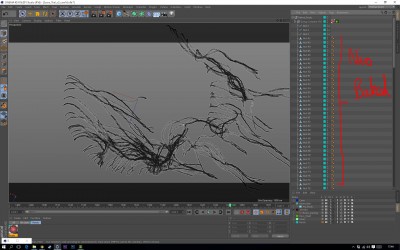

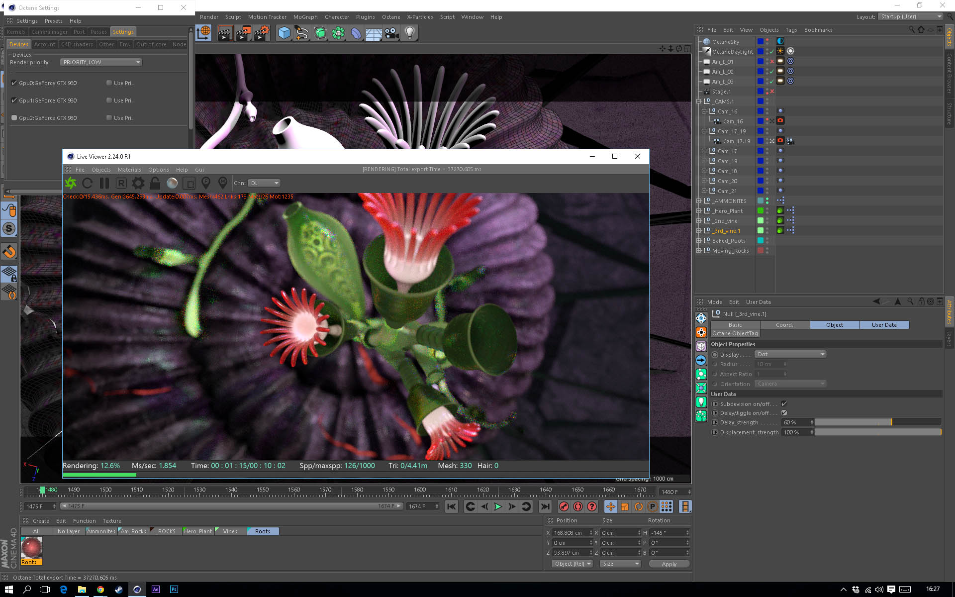

I dont know why the ms/sec value is slow... it always takes a long time to upload to octane... the image below shows the scene before it crashes...

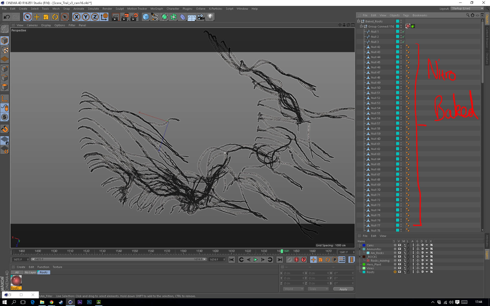

The only thing I can think is that I have NitroBaked my X-particle trails which makes a lot of single meshes for each frame - would that be a reason?
(This image is the layer in solo)

1- Much triangles takes much time to compile and prepare to renderer. Check and use low subdivisions for render mode. you should always use low poly as you can do.
2- Displacement can make this kind of slowness. Try without displacement and don't use high values.
3- Many objects which are movable can make it slow. But not so much.
4- Disable sli. It's not recommended for Octane.
Why 500mb? Have much textures? give it without textures but i can't check weekend. My plan is not clear at the moment.

I had no idea that SLI was bad for Octane... I thought that was the way the three cards work together. I will turn it off.

Ok I have just tried rendering to picture viewer with 3x GPUs with SLI turned off and I still get application crash:
