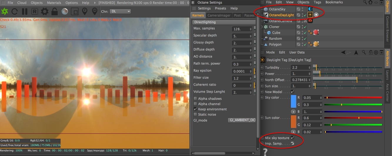

Octane is not like other render where you can define different HDRI for reflections, illumination and so on. But you can have the physical sky in conjunction with an HDR.
In C4d just add an HDRI Environment object and an Octane daylight and enable the "Mix Sky Texture" option in the attribute of the Daylight tag:
About the possibility to continue a scene prepared with the demo with the final version, the answer is yes ;)

I don't see the Mix option you have circled; demo versions are older than the release, correct? Or maybe I have something set incorrectly?
Mac Pro 5,1 3.33GHz 6 core / 1 x GeForce GTX980Ti 6GB / Mac OS 10.10.5
Posts: 10621
I guess that you don't have already the latest demo version:
https://home.otoy.com/render/octane-render/demo/
The latest version is 2.23.2 R6.2 and has the mix environment option ;)
