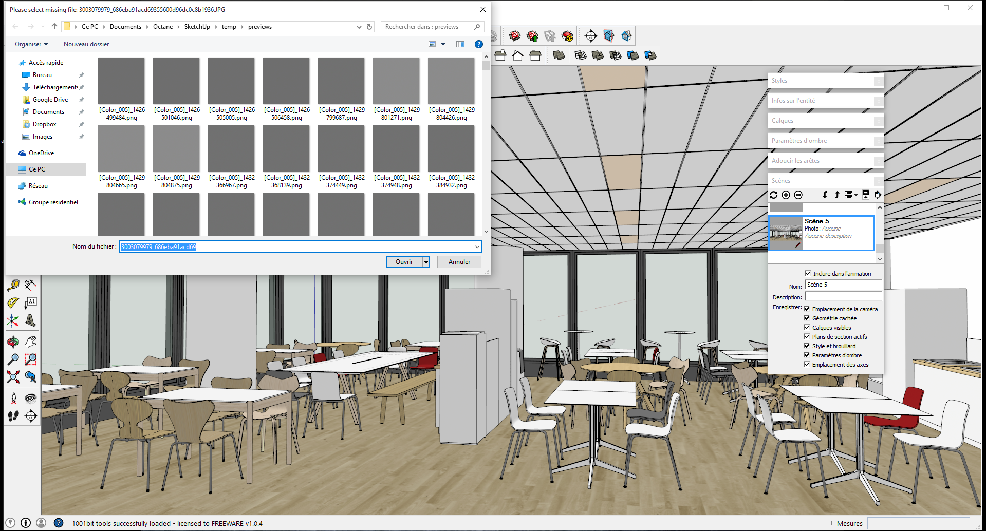

I've got 2 computers, which one of them have Sketchup with an Octane Standalone + Octane for Skp licence (my office/my home)
So, when i beginning working in one of them (in my office for exemple), save, and finishing my work at home, these is probleme:
What can i do ? Thank you

Hi!
In octane standalone you use file>save as package
File *.orbx

Hi, thanks
Yes, but i avoid working in the Standalone version in spit of the good advises from Smicha.
Because:

Pierre wrote:Hi, thanks
Because:
I think, in this case, each mesh has a different material. example:
Wood 1, Wood 2, 3 wood, wood ........ 60 etc.
You must assign a single material to the geometry, before exporting.
This is the flaw of the standalone. You can not go back.
You have to re-export it.
If this is the problem. :?
