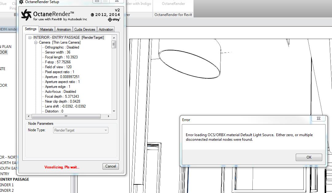

We are receiving an error from our Default Light Source "error loading OCS/ORBX material Default Light Source. Either zero, or multiple disconnected material nodes.
We are unable to reset the material as it provides a blank dialogue box.
Any ideas on how we reconnect or reset the material nodes?

Hi - at what point are you receiving this error? Are you trying to import the material from an ORBX or the LocalDB? Not sure what you mean by "blank dialog" - would it be possible to post some screenshots so I can get a better understanding of the problem you are experiencing?

Error occurs as is starts voxelizing.
I probably have not explained correctly. We are unable to select the material in the light which is the Default Light Source. In the attached image the default light source material is the underside of the linear fitting. We had an IES file attached and it initially worked. When we opened another view we received the message.

The Octane Material default is stored as an OCS file (ie. Octane scene) when you select Save as Default for a given material. It looks like in this case the "Default Light Source.OCS" file has become corrupt - so when loaded the default Octane material for the Revit Default Light Source material this error is being given. Would it be possible pls to send me the C:\Users\[username]\AppData\Local\OctaneRender for Revit\Defaults\Default Light Source.ocs file? After sending it to me - you can delete that file, and your scene should load correctly (but your custom Octane node setup for that material will be lost).

Thanks.
That worked. File attached.

Thanks for providing the OCS. It is indeed a blank Octane scene. If this happens to you again, pls let me know and I will add some code to handle this scenario better.
