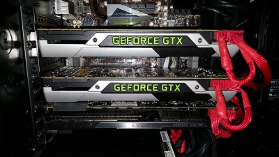

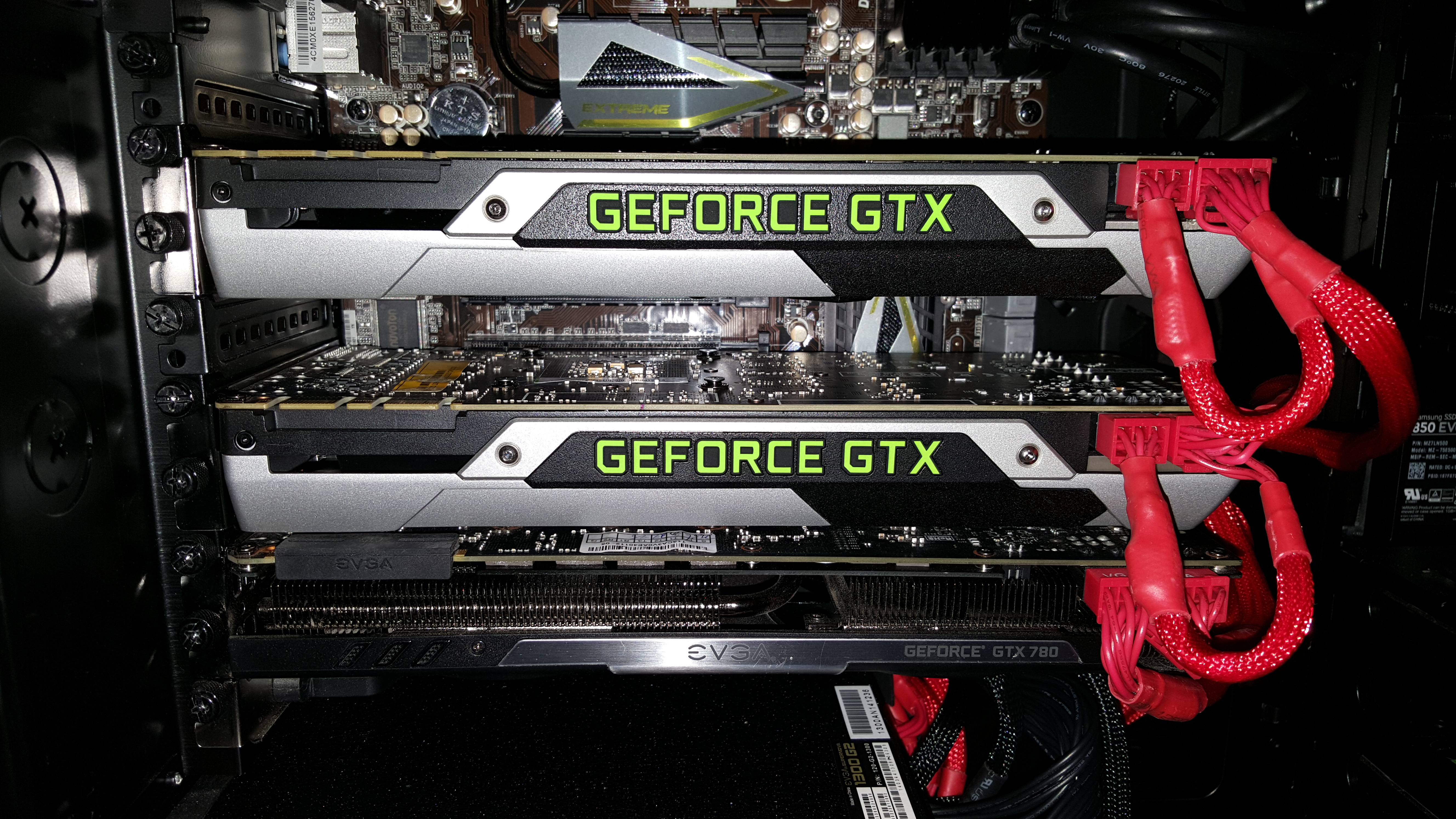

I recently upgraded My computer from a EVGA 780 and an EVGA 970 to 2 ZOTAZ 780ti's and a single EVGA 780. And I've only noticed a slight decrease with render times. I was kind of hoping for more than a 10%-15% difference with 3 times the power. Other build specs: AMD 8350, 32GB Corsair Dominator DDR3, 500GB Samsung EVO SSD, Ultra 850W PSU.
I've watched Understanding Octane For C4D and know how to adjust render settings accordingly. And I'm currently rendering out a pretty simple scene.
Just wondering if anyone had any insight.

Did you have good air between the two cards and now you have three cards close to each other?
(If the cards have less airsace they perform less because they get hot quicker.)

Unfortunately I had to sacrifice airflow between 2 of the cards. But they don't go over 70....even while rendering. which is about the same the 780 always sat at before during renders. But still....there should be a lot more difference in render times.
