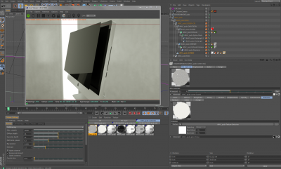

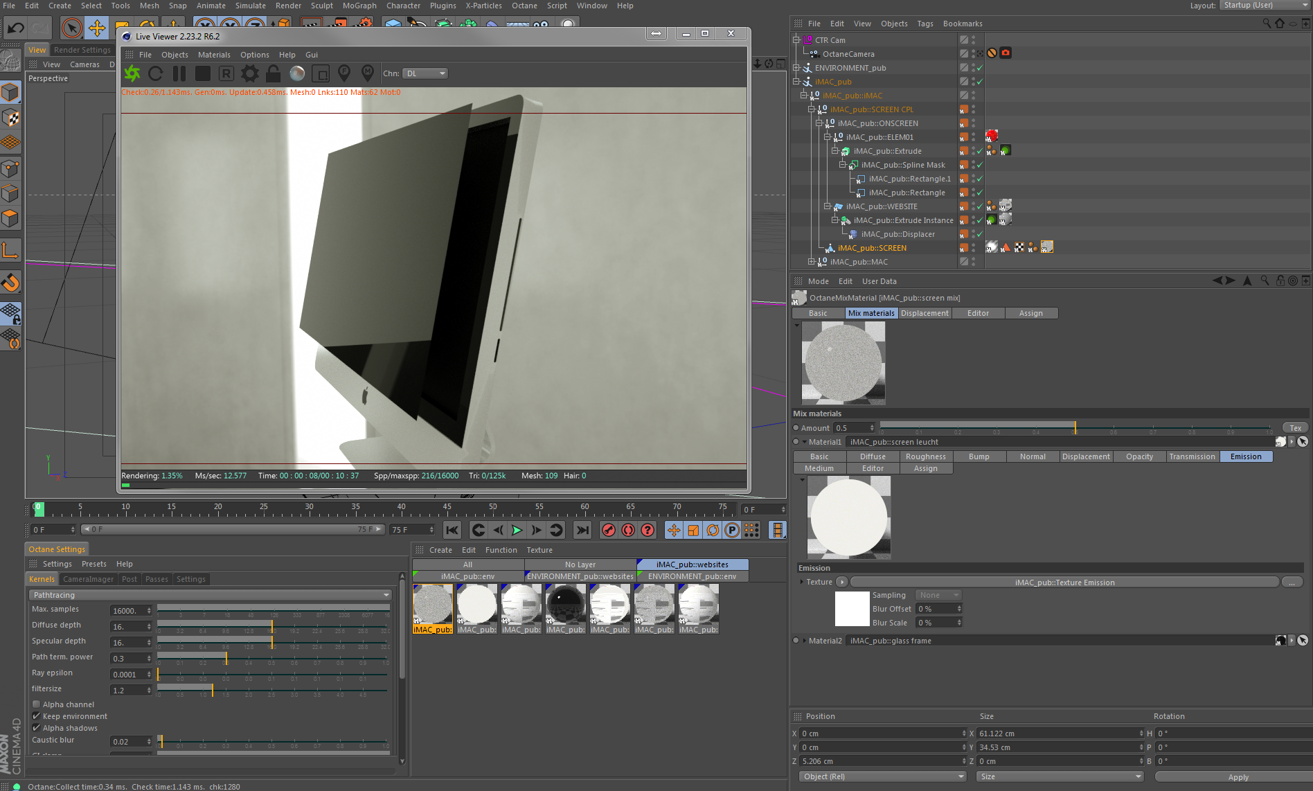

Hey guys,
Im experiencing an issue with referenced Objects. In short: Emissions from Xref'd objects seem not to be calculated. The attached picture shows an iMac, whose Screen is supposed to emit a picture, while it still has reflections on it (thats why it is in a mix material). But even without the mix material, the emitting material is rendered diffuse-only.
Known issue?

hi, the info here might help:
viewtopic.php?f=30&t=43172&p=209066
