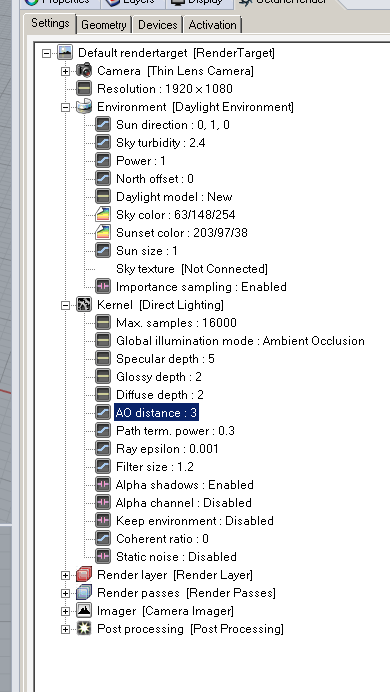

it could be great if by click on an option of the option tree the value is selected and can direct typed in. So with less clicks the value could be changed. For example AO distance: click on the option and simple type 5 -> enter would be the short way. See screenshot - here the "3" could be preselected.

I have tried implementing this before, however auto-selecting the edit box controls introduces a lot of problems. This is primarily due to RhinoCommon or .NET (I'm not sure which) firing a "text has changed" event a second or two after you enter a new value in an edit box, so you might have max samples set to 10000, and you want to change that to 2000, and you press the '2' key and pause and the plugin receives a "change" event and changes the number of samples to 2, which is not what you wanted.it could be great if by click on an option of the option tree the value is selected and can direct typed in. So with less clicks the value could be changed. For example AO distance: click on the option and simple type 5 -> enter would be the short way. See screenshot - here the "3" could be preselected.

Oh, that's hard for the programmer.

Hi Paul
Direct tree editing would be great

This would be nice to have, but creates a lot of problems due to the edit boxes gaining and loosing focus resulting in the render restarting, which I think will be unacceptable for you.Direct tree editing would be great
